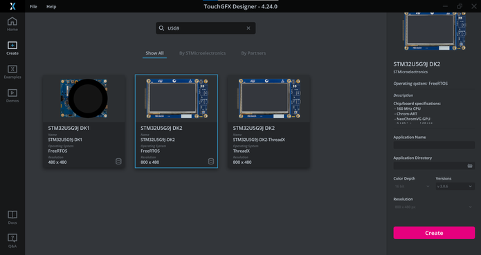

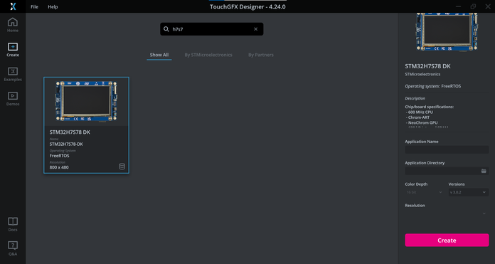

We are examining to use either STM32H7S7L8 MCU or STM32U5G9J for a project involving fairly involved graphics, requiring smooth animation and effects such as frame rotations, vertical and horizontal moving scales.
Are either of the above a good choice for such application?
How far does TouchGFX graphics framework library support the graphics mentioned above?
Are there significant new features available in TouchGFX 4.24 to support animation effects such as frame rotations etc.?
One of the reasons to examine the above MCUs is that they include advanced graphics accelerators (Neochrom and Vector graphics)? Can the TouchGFX graphics take advantage of the new graphics capabilities of these MCUs?
