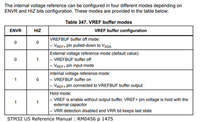

Hello @KHarb.1,
First, make the difference between Vref+ and VREFBUF: see this page for better explanation
- VREF+ is the pin on the package linked to VREF
- VREFBUF is the internal reference that can provide reference voltage to VREF+
So when you talk about "VREFBUF outputs" I assume that you means VREF+.
"HIZ" bit defines if VREF+ output is high impedance or low impedance.
If you want to output VREFBUF voltage to provide reference externally you must set HIZ = 0 and ENVR = 1.
Hope that answers your questions,
Best regards,
Melchior

all right, I misunderstood your question,
From my side I managed to change HIZ bit by changing the configuration of VREFBUF in CUBEMX. The HIZ bit value matches the configuration name on the table I sent earlier.
In the code itself the bit is set in the file stm32XXxx_hal_msp.c : (example VREFBUF in hold mode)
void HAL_MspInit(void)
/* USER CODE BEGIN MspInit 0 */
/* USER CODE END MspInit 0 */
/* System interrupt init*/
/** Enable the VREF clock
__HAL_RCC_VREF_CLK_ENABLE();
/** Enable the Internal Voltage Reference buffer
HAL_SYSCFG_EnableVREFBUF();
/** Configure the internal voltage reference buffer high impedance mode
HAL_SYSCFG_VREFBUF_HighImpedanceConfig(SYSCFG_VREFBUF_HIGH_IMPEDANCE_ENABLE);
/* USER CODE BEGIN MspInit 1 */
/* USER CODE END MspInit 1 */
