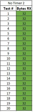

Best answer by CharlieMangold
ST has found our issue. We simply missed the pin assignment. When we read Table 12 of the data sheet, PA4's DAC_OUT1 is listed under the "Additional functions" column right next to the "Alternate functions" column. We configured it as a alternate pin assignment instead of a analog pin assignment as show in some of their Low Level driver example code. The DAC output still works and things are fine until the SPI is run(which is one of PA4's alternate pin configurable s.)
Thanks ST.

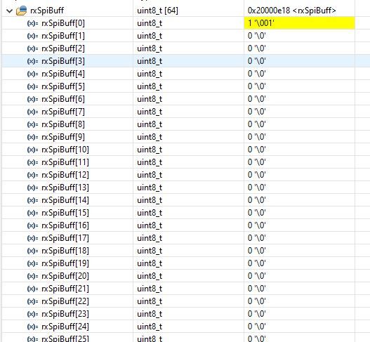

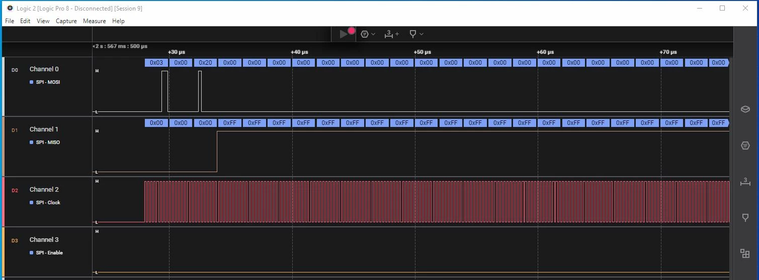

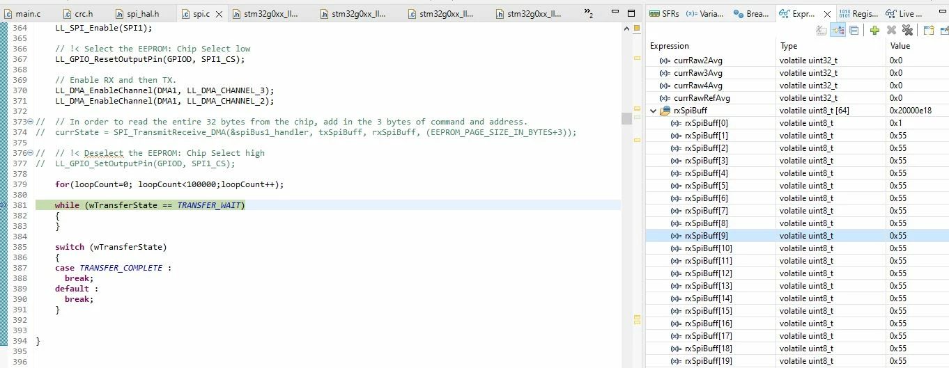

What is in your Rx DAM buffer? ("nothing" is not possible).
All 0xFF? then you might have read the empty page from external flash.
If still all 0x00? Maybe an issue with the connections.
Fill the buffer before you read with a pattern and see with which value it was overwritten (and it if it was overwritten).

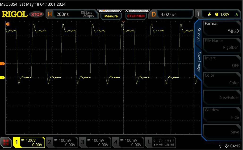

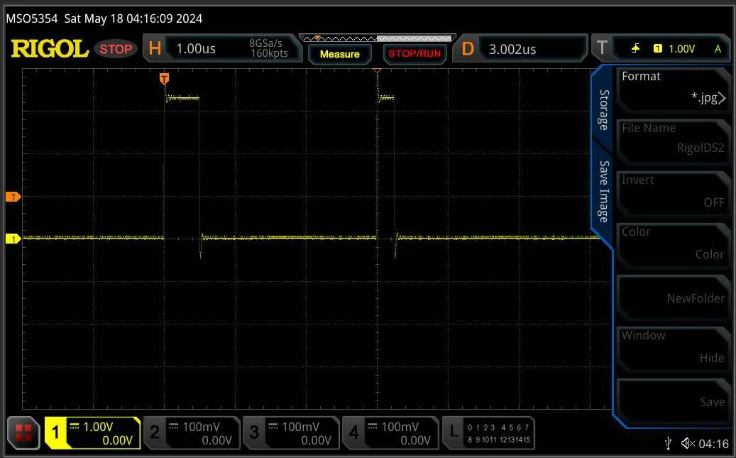

The scope picture shows something reasonable (reading an "empty"/not programmed location), all 0xFF.
What is "nothing"?
BTW: how is nHOLD connected?

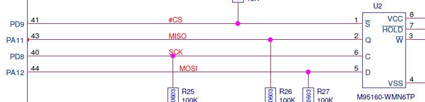

And:
You have pull-ups on your schematics? (100K, not clear to see).
But you enable PULL_DOWN on pin config?
WHY?????
This seems to be wrong: 100K external pull-up and 100K internal pull up (not sure, maybe even a bit stronger) - you "kill" all your logic levels! the chip would see a digital signal right in the middle, e.g. as 1.5V and it violates the CMOS digital logic levels.
Use an analog scope to verify if you have a conflict between external pull-ups and internal pull-downs.

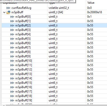

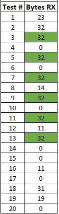

This is the RX buffer when the SPI initialization code has set everything to zero and we have hit the TX DMA complete interrupt:

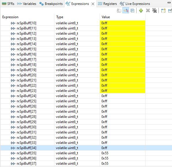

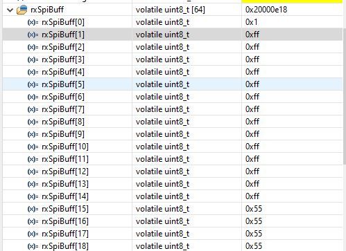

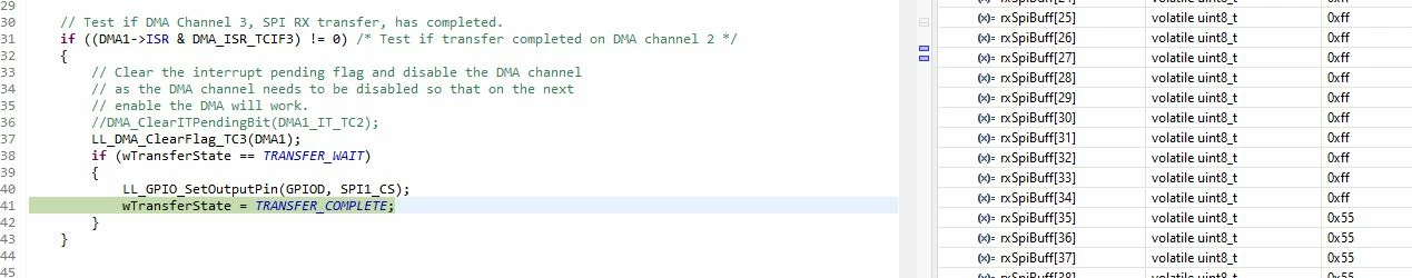

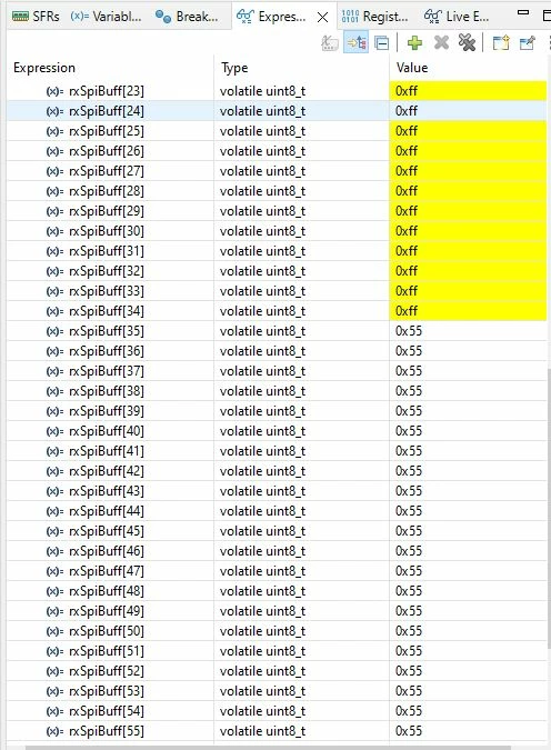

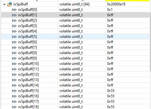

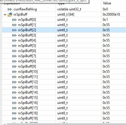

Here is a run when we add a memset to load the RX buffer with 0x55's.
Seems we forgot to put a volatile declaration of the RX buffer so stopping the debugger was giving a false impression. Here is it in the main loop after a proper volatile declaration. Not sure why the first byte is a 0x01 and there are only 14 locations filled:
- how is nHOLD connected? Pulled to 3.3v
- You have pull-ups on your schematics? MISO, MOSI and SCK are pulled down.
So at this point almost half the SPI data is making it into the RX buffer and we are insuring that we stop the debugger out in the main loop.
The RX DMA size we bumped up to match the TX DMA size, the DMA's are configured to be byte aligned,  the RX DMA channel is enabled before the TX DMA channel and the logic analyzer shows 32 bytes of data coming out of the EEPROM chip. Does FIFO effect the DMA data?

	LL_DMA_SetDataLength(DMA1, LL_DMA_CHANNEL_2, (EEPROM_PAGE_SIZE_IN_BYTES+3));
	LL_DMA_SetDataLength(DMA1, LL_DMA_CHANNEL_3, (EEPROM_PAGE_SIZE_IN_BYTES+3));
	// Enable SPI1.
	LL_SPI_Enable(SPI1);
	// !< Select the EEPROM: Chip Select low
	LL_GPIO_ResetOutputPin(GPIOD, SPI1_CS);
	// Enable RX and then TX.
	LL_DMA_EnableChannel(DMA1, LL_DMA_CHANNEL_3);
	LL_DMA_EnableChannel(DMA1, LL_DMA_CHANNEL_2);

CharlieMangold
Senior
May 17, 2024
Back to nothing in the RX DMA buffer again (except the first byte) using the same configuration. Going to have the ST chip solder pins checked.

- The pulldowns are not populated.
- No soldering issues with the ST chip.
- Running it numerous times gives mixed results and maybe 10% of the time all the data is there.
- Because we run four ADC's, a DAC and the SPI bus using DMA's, pushed the SPI DMA channels to very high priority but this made no difference.
- We will go to checking clocking signal levels but the logic analyzer seemed happy with what it had.
CharlieMangold
Senior
May 17, 2024
Some updates
- When on the rare occasion that all the data is received, the transmit complete interrupt will fire.
- There is a little ringing on the signals(as measured from the ST micro input pin), but is this enough to radically effect large portions of RX data?
SCK
MOSI

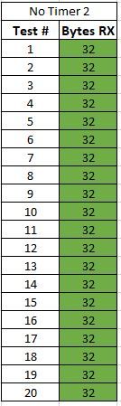

Finally making some progress but this does not look good. Currently there are four DMA channels running: ADC, DAC, SPI RX and SPI TX. The ADC is taking 4 different channels worth of data and the DAC is sending out a 10khz wave. The first test was to change the DMA channel priority to ADC(chan 1) LOW, DAC(chan 4) Medium, SPI TX(chan 2) High and SPI RX(chan 3) Very high. We when we do receive data we get more, but the test is still bad.
We now turned off Timer 2, which is running the DAC to drive the 10khz wave. All the data is now being properly received.
