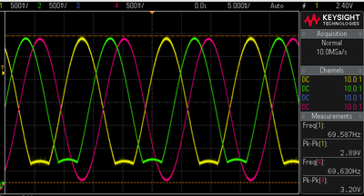

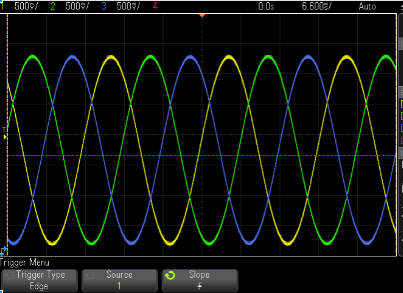

Hi All,
I have a further query about the DAC output for this that is puzzling me, I have 3 sine waves all DAC conversions triggered correctly but I seem to have lost the bottom portion of the sine 1 and 2 ( these are on the same DAC) , it was working fine until I connected the output of this on pin PA5 and PA6 to the input of an OPAMPS, I think I have somehow damaged the buffer that I'm using inside the STM32 and it no longer outputs the full swing in voltage.
Here's a screen grab of the scope for the 3 phases. Has anyone seen this before? and is it possible to calibrate the output to correct it?
Thanks
Nick
