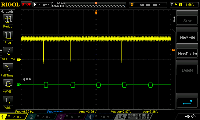

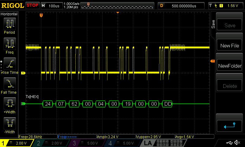

I am trying to receive a frame containing 10 bytes of serial data, each frame is transmitted at a 100ms rate.
However, as the UART can start receiving the 10 byte frame at any point in time, the received data is becoming out of sync.
How do I sync the UART peripheral so that it always starts receiving at the start of the 10 byte frame ?
Below is a scope capture of the 10 bytes of serial data:
Below is a scope capture of the 10 bytes of serial data being sent at a 100ms rate:

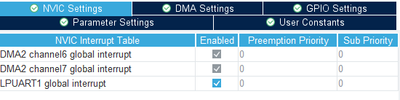

The UART is configured as shown below and the rx buffer is a size of 10.
The 10 bytes are transmitted by a electronic speed controller, used for radio control applications and contains the following data:
Byte 0: Temperature
Byte 1: Voltage high byte
Byte 2: Voltage low byte
Byte 3: Current high byte
Byte 4: Current low byte
Byte 5: Consumption high byte
Byte 6: Consumption low byte
Byte 7: Rpm high byte
Byte 8: Rpm low byte
Byte 9: 8-bit CRC

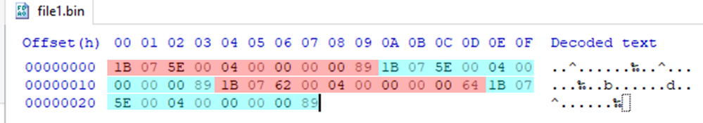

‎2024-02-06 7:20 AM - edited ‎2024-02-06 7:46 AM
It works correctly when I use the HAL_UARTEx_ReceiveToIdle_IT function (as suggested by KMill). The project is attached for reference.
I don't bother decoding the telemetry anymore (i.e. the process_telem function), instead I just write the 10 bytes of serial data directly to the SD card each time the packet is received.
I will need to implement some post processing (using MATLAB, Python etc) to read the packets from the SD card, then decode each packet into the measurements and finally check the CRC.
At the moment my code just saves 4 packets (i.e. 4 x10 bytes) of serial data to the SD card. When I open the file on the SD card it shows the 4 packets (I have highlighted each packet red or blue)...
