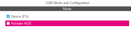

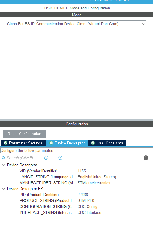

My STM32F0 won't show up under "Ports " in my device manager. It does, however, show up under "Universal Serial Bus Devices". I'm trying to print to a serial monitor. I've spent over 12 hours (low guess) trying to troubleshoot this issue. Here is what it looks like in my device manager.0693W00000KbNFGQA3.pngHere are some of the settings I've tried

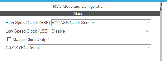

0693W00000KbNGBQA3.pngI did also try using RCC as Crystal/Ceramic Resonator

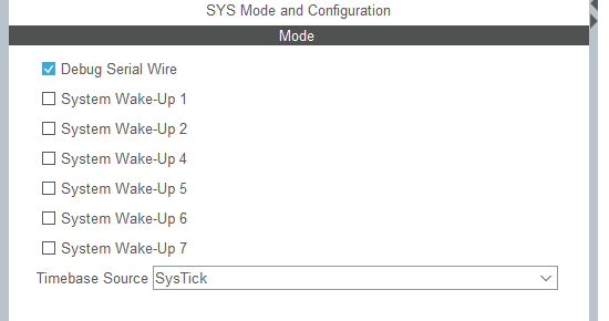

0693W00000KbNGGQA3.png0693W00000KbNGVQA3.png0693W00000KbNDLQA3.pngWhat do I need to do so I can get my device to show up as COM 4 or COM 6 or some other COM channel?

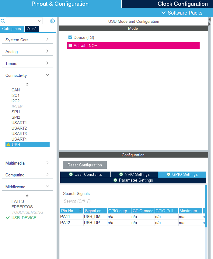

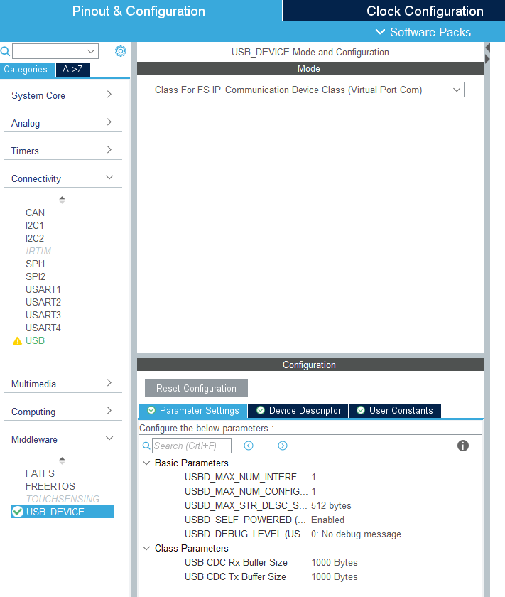

1) Connectivity -> USB -> Device (FS) box checked
0693W00000Np8m2QAB.png2) Middleware -> USB_DEVICE -> Class For FS IP -> Communication Device Class (Virtual Port Com) option selected

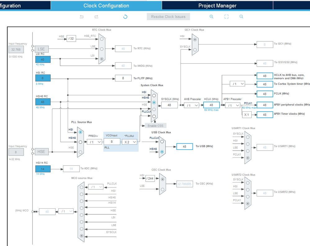

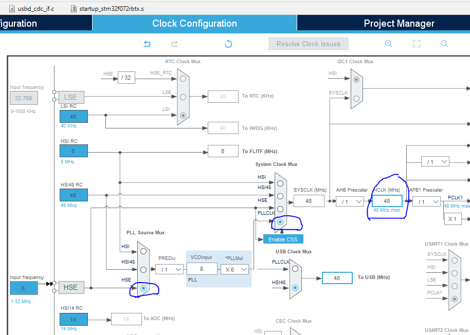

0693W00000Np8lnQAB.png3) Here's my clock configuration
0693W00000Np8mCQAR.png3) Save and then the code generates

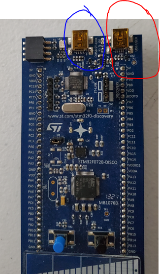

5) I use the ST-LINK port on my board (circled in blue) to flash the code, and once the code has been flashed I unplug the cable from the ST-LINK port and insert it into the USB USER port (circled in red). It is at this moment, when the cable is connected to the USB USER port that I can see my little controller under PORTS in the device manager, and I can then connect to the serial monitor and I will see the message displayed.
0693W00000Np8nUQAR.pngLet me know if that was clear, and if it helped, and if you have any questions still. I'm still pretty new to this, but these are the steps I took to get it working.
Hey @CR72​, Thank you for the detailed response! I�? am basically doing everything that you are doing with the exceptions that our board only has one MINI USB port, and we were trying to use USART to transmit the data to VCOM not CDC, I�? am not sure what the difference is but maybe I�? can give that a shot. The fact that we only have one MINI USB port available makes me think that @Pavel A.​'s response might be a viable solution. Thank you again!
