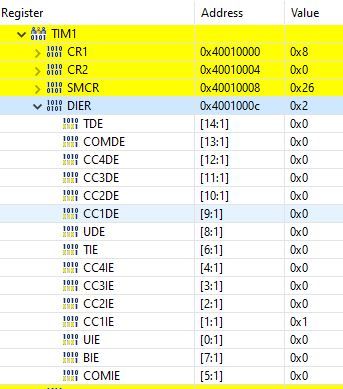

BMcKe.2
I created a small function to Toggle a GPIO output high and then low again to generate a pulse that I can see on an oscilloscope.
I call this function from my HAL_TIM_PWM_PulseFinishedCallBack and the pulse appears in the correct position after each of the 5 pulses. I then call the function from HAL_TIM_Period_ElapsedCallback which I thought would create a final pulse at the end of the pulse train but it doesn't appear.

BMcKe.2
0693W000008zpWMQAY.jpgThe UIE bit for DIER for TImer 1 is set to zero.
waclawek.jan
Well, then TIM1_UP_IRQHandler() won't be called.

BMcKe.2
Just for reference, the work-around is to write directly to the TIM1 DIER register with the bits set to 1 for CC1IE and UIE to turn on both the Capture/Compare Interrupt and the Update Interrupt.
Place this instruction after the Cube IDE generated code so that it overwrites the incorrect Cube IDE settings.

BMcKe.2
HAL_TIM_Base_Start_IT does indeed set the UIE bit in the DIER register but I need to generate a PWM pulse output with timer 1, so I can't use HAL_TIM_Base_Start_IT.
When I use HAL_TIM_PWM_Start_IT, it should also set the UIE bit to one but it doesn't. I assume this is a bug in CubeMX.
To fix this, I write directly to the DIER register using TIM1->DIER=0x3; right after the HAL_TIM_PWM_Start_IT instruction. That sets the UIE bit to one and the interrupts then work.
