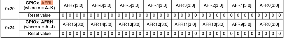

OK, need some hours to understand a part of your answer, but so far an example for my Clock on PI1:
  1. Datatsheet In the Table 12. STM32F745xx and STM32F746xx alternate function mapping (continued): I see that I have to map PI1-Pin to AF5 (for I2S2_CK)
  2. So the "number"of function is 5
  3. In the RM on page 199 (GPIO) I read that all GPIOs have the alternate function selection registers GPIOx_AFRH and GPIOx_AFRL. But what exactly I have to write in to this registers was not clear for me. Do I have to write a five somewhere? In the AFR5-Section?0690X000006BvDtQAK.png
  4. In the MODER Register (GPIOI__MODER) i have to set the forth bit and clear the third, to say PI1 has an alternate function.
In addition I have also to setup the ouput states, speed selection etc. How do I change this registers in C? Which function do I have call, or which Macro do I have to use?
Yes; but in Cube the "magic" in the init function as mentioned above does that. I do this using the usual bit manipulation routines, utiilizing macros defined in the standard CMSIS-mandated device header:

Hmm.. when I read this:
http://www.se.rit.edu/~swen-563/resources/STM32L476/GPIO%20and%20Alternate%20Function%20Setup.pdf
.. and combine it with your code it shoud be:
#define GPIO_AFRL_AFRL1                    ((uint32_t)0x000000F0)
#define GPIO_AFRL_AFRL1_0                  ((uint32_t)0x00000100)
#define GPIO_AlternateFunction_I2S2	   ((uint32_t)0x00000005)
is this correct?
    #define GPIO_AFRL_AFRL1_0                  ((uint32_t)0x00000010)
