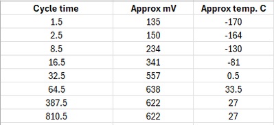

When adding the internal temperature sensor reading in the STM32H750 micro FW, out of curiosity I collected voltage reading data based on different sampling times.
Based on our ADC clock speed (37.5 MHz) and the datasheet requirements for the temperature sensor (minimum sampling time 9 us) I calculated that the minimum cycles required for the ADC sampling are 337.5.
This works out well and with the sufficient sampling time provided I obtain appropriate temperature reading of 27C.
Now it seems understandable that when not enough sampling time is provided, the internal ADC SAR capacitors do not have enough time to charge and in result the input voltage conversion is lower than actual.
However, I am curious about the result for the cycle time 64.5, where the resulting voltage is slightly greater than actual (all the results are consistent i.e. I can run the same FW in a loop and always roughly the same counts are detected).
Looking at the ADC description in AN2834 section 2.1, we can see that the final SAR result depends on a number of comparations and the position and number of capacitors used in each approximation step will depend on the input voltage and previous step results.
Is it simply due to chance that in this case the voltage reading is higher than expected but it could be either way since any of the capacitors may not have charged as expected? How could the ADC error be related to the lower bits (smaller charge capacitors) if they should in theory charge faster than the largest required cap to detect ~600 mV?

I have only a rudimentary understanding of how SAR ADCs work, but if I understand you and them correctly - you are assuming that the approximation value should approach the sampled voltage monotonically - and that assumption is not valid.
The WP article on SAR ADCs suggests the helpful mental model of the SAR process as binary search.
In line with that, what you should see at every step is only that the absolute value of the error, between the approximation and the sampled value monotonically decreases (or to be pedantic, non-increases) with each step.
And in fact, in your example, it does:
Cycle timeApprox mV.|622mv-approx|
1.5135487
2.5150472
8.5234388
16.5341281
32.555765
64.563816
387.56220
810.56220

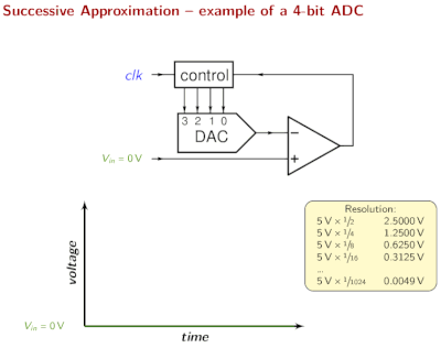

As another example, this animation from WP  shows that, depending on the sampled value, there can be some "overshoot" during some intermediate step(s), just like in your example.
https://en.wikipedia.org/wiki/File:4-bit_Successive_Approximation_DAC.gif
759px-4-bit_Successive_Approximation_DAC

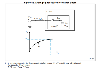

3. Such ADC has an input sample-hold cap, maybe 5pF , that has to be charged to the input voltage it should get.
So needs some minimum time, depending on the source impedance also.
Now you know, why its working fine, if you keep to this (calculated) values for sampling time vs. source impedance.
