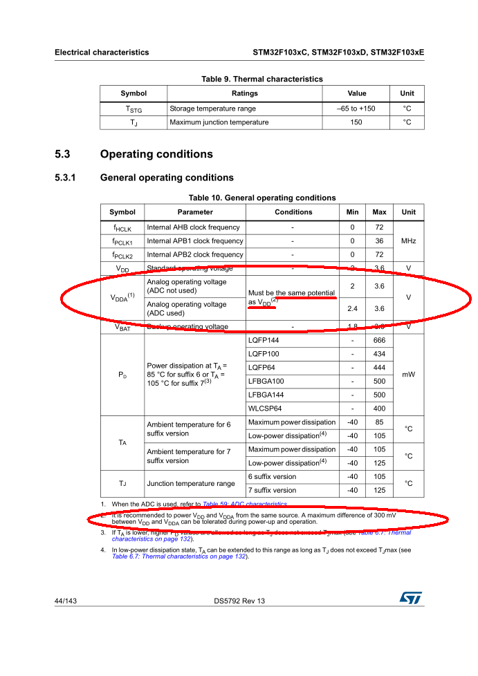

‎2021-04-29 5:11 AM
When constructing the power source for VDDA, you have to observe this:
