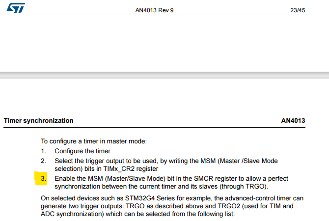

I will try to use two timers with a master timer that clocks a slave timer. In this way I should achieve my goals.
I found this very useful STM32 cross-series timer overview - Application note
But can you help me in understanding the functionality highlighted in yellow?
