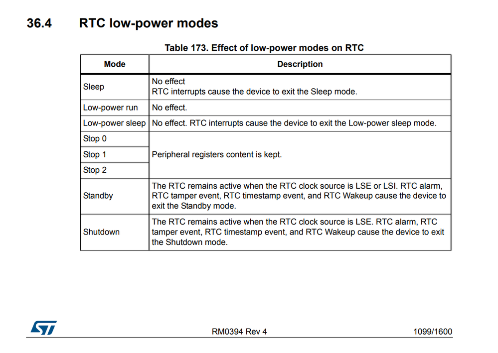

SAkhi.951
  1. Yes
  2. According STM reference manual
0693W00000KbweIQAR.pngAlso update on behaviour.
When the wake up interrupt is generated, system does not leave __WFI() instruction.
But when interrupt from UART comes, then it moves out form ISR instruction, and on the next wake up interrupt it starts working as it should.
