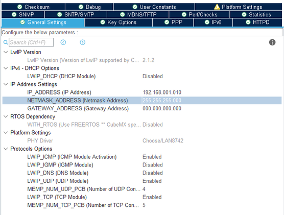

Troubleshooting Already Performed
  • Tested both Static IP and Dynamic IP (DHCP) configurations.
  • Verified IP address, subnet mask, and gateway settings.
  • Tried multiple Ethernet cables to rule out cable-related issues.
  • Rebuilt and reflashed the project multiple times.
  • Verified that the firmware flashes successfully and runs without build errors.
Despite these steps, the board does not respond to ping requests.

I also installed STM32CubeIDE version 1.9.0 and flashed the firmware onto the board. After flashing the code, I tested whether the assigned IP address responds to ping requests; however, the ping test still fails.

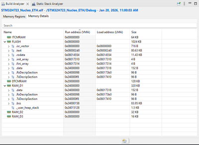

While flashing the project the memory locations are
The CubeMX parameter settings are,

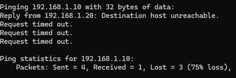

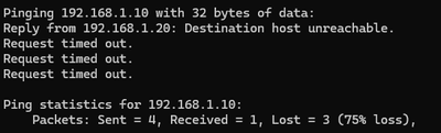

The ping test result is,
For your reference, I have attached the project folder used for this test.

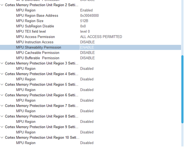

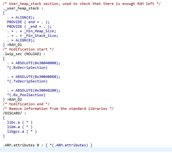

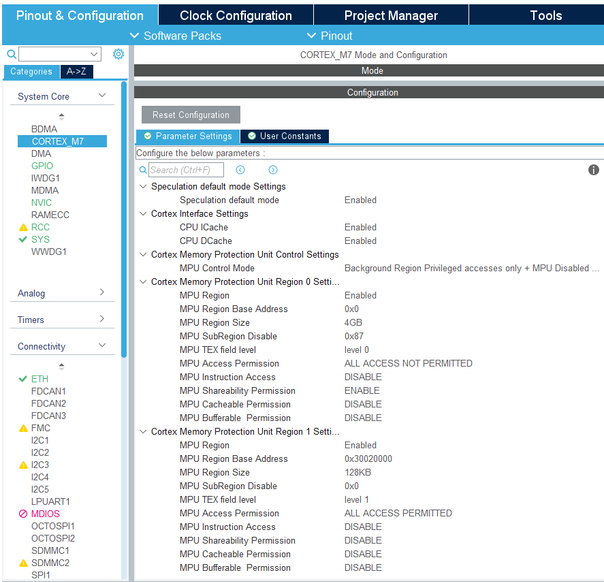

Your MPU configuration is incorrect, and the Rx_PoolSection must not be placed in SRAM2.
For STM32H7 Ethernet + LwIP, RX buffers must be located in D1 RAM (address range 0x24000000–0x30007FFF).
1) Update the linker script:
.lwip_sec (NOLOAD) :
. = ABSOLUTE(0x30000000);
*(.RxDecripSection)
. = ABSOLUTE(0x30000100);
*(.TxDecripSection)
} >RAM_D2 AT> FLASH
2) Configure the MPU as described in the following ST article:
https://community.st.com/t5/stm32-mcus/how-to-create-a-project-for-stm32h7-with-ethernet-and-lwip-stack/ta-p/49308

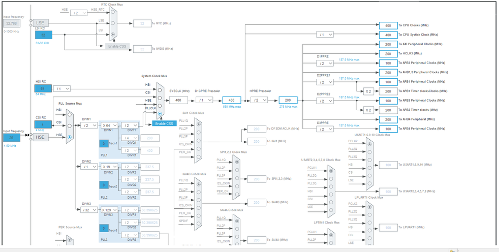

Project creation
Board: NUCLEO-H723ZG
Basic configuration:
Configure clock tree:
  • In pinout/RCC, configured HSE in bypass mode.
  • In clock tree, configured 400MHz for core.

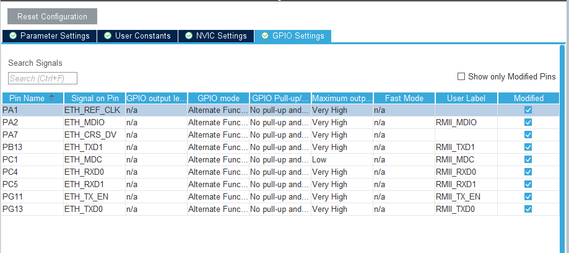

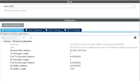

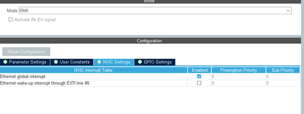

    Ethernet configuration:
  • Enabled Ethernet interrupt
    • Set GPIO pin speed to Very High.
    •  ETH_MDC speed couldn't be changed
      Cortex-M7 configuration:
    • Enable ICache and DCache.
    • Enable memory protection unit (MPU) in “Background Region Privileged access only + MPU Disabled ...” mode.

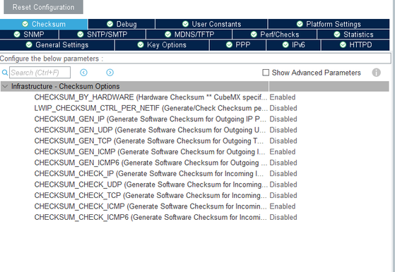

      Checksum:

      Modifying the code (STM32CubeIDE):

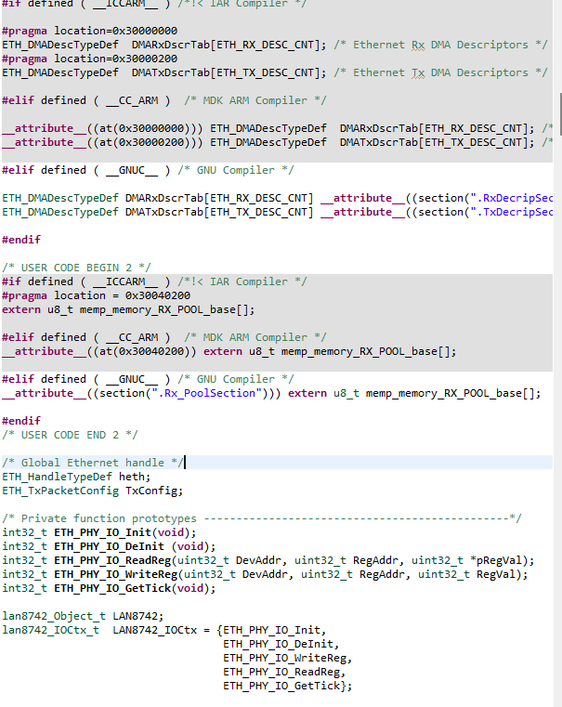

      ethernetif.c:
      FLASH.ld:

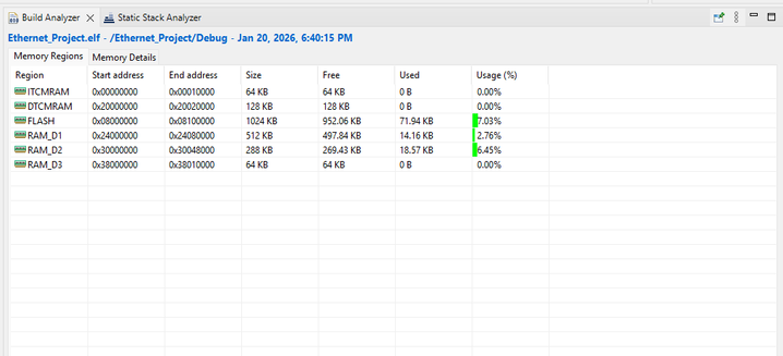

      Finally, I am able to receive a response when performing the ping test, as shown below.
      However, after following all of your instructions earlier, I was initially unable to ping the IP address. Could you please help clarify why the ping was not successful at that stage?
I have attached my FLASH.ld file below for you reference:

Kindly review it.
Refer to the following article carefully instead of directly copy-pasting the configuration:

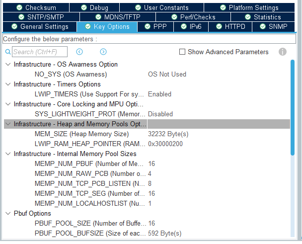

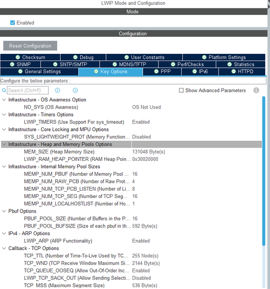

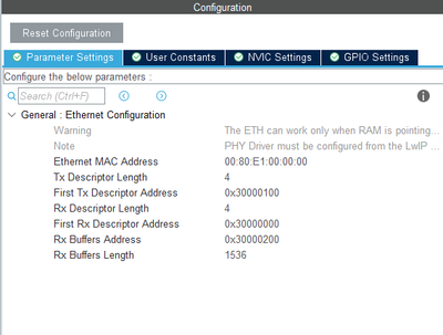

Your current configuration targets STM32H74x/H75x devices, but you are using STM32H723ZGT6, which has only 32 KB of SRAM2.Therefore, the RX buffers must be placed in AXI SRAM at 0x24000000, not in SRAM2. Also, the lwip_sec linker section is incorrect. Please refer to my previous reply for the correct linker script configuration.
1)LWIP_RAM_HEAP_POINTER (RAM Heap Pointer) should be in SRAM2 @0x30000200"
2) MEM_SIZE (Heap Memory Size) = 32232
~ AJ
The shared article contains the memory allocation for the STM32H74x/H75x devices only, Whenever I'm using the STM32H723ZGT6, I have some confusions.
I have done the configuration/code & allocation with the help of the article:  https://community.st.com/t5/stm32-mcus/how-to-create-a-project-for-stm32h7-with-ethernet-and-lwip-stack/ta-p/49308.
Now with your guidance, I've changed the LWIP_RAM_HEAP_POINTER MEM_SIZE (Heap Memory Size) respectively.
and also updated the Flash.ld with your guidance. Review it.

DTCMRAM (xrw) : ORIGIN = 0x20000000, LENGTH = 128K
FLASH (rx) : ORIGIN = 0x08000000, LENGTH = 1024K
RAM_D1 (xrw) : ORIGIN = 0x24000000, LENGTH = 512K
RAM_D2 (xrw) : ORIGIN = 0x30000000, LENGTH = 288K
RAM_D3 (xrw) : ORIGIN = 0x38000000, LENGTH = 64K
/* Define output sections */
SECTIONS
/* The startup code goes first into FLASH */
.isr_vector :
. = ALIGN(4);
KEEP(*(.isr_vector)) /* Startup code */
. = ALIGN(4);
} >FLASH
/* The program code and other data goes into FLASH */
.text :
. = ALIGN(4);
*(.text) /* .text sections (code) */
*(.text*) /* .text* sections (code) */
*(.glue_7) /* glue arm to thumb code */
*(.glue_7t) /* glue thumb to arm code */
*(.eh_frame)
KEEP (*(.init))
KEEP (*(.fini))
. = ALIGN(4);
_etext = .; /* define a global symbols at end of code */
} >FLASH
/* Constant data goes into FLASH */
.rodata :
. = ALIGN(4);
*(.rodata) /* .rodata sections (constants, strings, etc.) */
*(.rodata*) /* .rodata* sections (constants, strings, etc.) */
. = ALIGN(4);
} >FLASH
.ARM.extab : { *(.ARM.extab* .gnu.linkonce.armextab.*) } >FLASH
.ARM : {
__exidx_start = .;
*(.ARM.exidx*)
__exidx_end = .;
} >FLASH
.preinit_array :
PROVIDE_HIDDEN (__preinit_array_start = .);
KEEP (*(.preinit_array*))
PROVIDE_HIDDEN (__preinit_array_end = .);
} >FLASH
.init_array :
PROVIDE_HIDDEN (__init_array_start = .);
KEEP (*(SORT(.init_array.*)))
KEEP (*(.init_array*))
PROVIDE_HIDDEN (__init_array_end = .);
} >FLASH
.fini_array :
PROVIDE_HIDDEN (__fini_array_start = .);
KEEP (*(SORT(.fini_array.*)))
KEEP (*(.fini_array*))
PROVIDE_HIDDEN (__fini_array_end = .);
} >FLASH
/* used by the startup to initialize data */
_sidata = LOADADDR(.data);
/* Initialized data sections goes into RAM, load LMA copy after code */
.data :
. = ALIGN(4);
_sdata = .; /* create a global symbol at data start */
*(.data) /* .data sections */
*(.data*) /* .data* sections */
*(.RamFunc) /* .RamFunc sections */
*(.RamFunc*) /* .RamFunc* sections */
. = ALIGN(4);
_edata = .; /* define a global symbol at data end */
} >RAM_D1 AT> FLASH
/* Uninitialized data section */
. = ALIGN(4);
.bss :
/* This is used by the startup in order to initialize the .bss section */
_sbss = .; /* define a global symbol at bss start */
__bss_start__ = _sbss;
*(.bss)
*(.bss*)
*(COMMON)
. = ALIGN(4);
_ebss = .; /* define a global symbol at bss end */
__bss_end__ = _ebss;
} >RAM_D1
/* User_heap_stack section, used to check that there is enough RAM left */
._user_heap_stack :
. = ALIGN(8);
PROVIDE ( end = . );
PROVIDE ( _end = . );
. = . + _Min_Heap_Size;
. = . + _Min_Stack_Size;
. = ALIGN(8);
} >RAM_D1
/* Modification start */
*(.RxDecripSection)
*(.TxDecripSection)
} >RAM_D2 AT> FLASH
/* Modification end */
/* Remove information from the standard libraries */
/DISCARD/ :
libc.a ( * )
libm.a ( * )
libgcc.a ( * )
.ARM.attributes 0 : { *(.ARM.attributes) }
