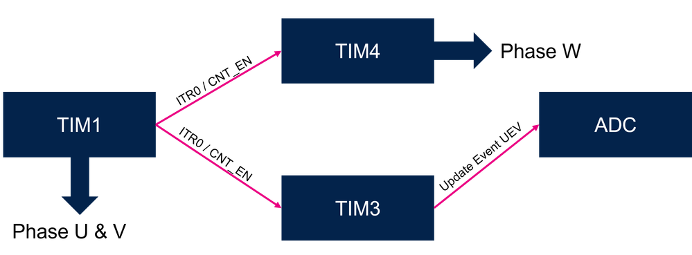

Indeed two solutions exist:
- Trigger the ADC on OCxREF signal meaning that ADC trigger is 90° out of phase with Overflow flag
- Cascade a third timer to generate a trigger on ADC. This timer is a slave of the TIM1 also.
Below a scheme of how timers and ADC are interconnected
TIM1 & TIM4 are setup as center aligned 3 (Up and Down CNT).
TIM3 is setup as Up CNT where ARR = 2*(ARR_TIM1)-1. Be sure that ARR of TIM1 doesn't exceed 65536/2, else we recommend the usage of TIM2/5 (32-bit resolution).
Please note that:
- TIM2/3/8 can be used to trigger ADC for regular conversion
- TIM2/5 for injected conversion. For TIM5, it must be triggered by TIM4 CNT_EN in aid of TIM1
Blue --> PWM signal
Red --> End of ADC conversion (IO toggling)
As a result, ADC will be synchronized with Overflow of TIM1 & TIM4
Let me know if it's unclear or you need more clarification.

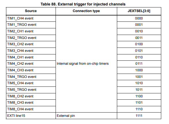

‎2023-06-01 7:49 AM - edited ‎2023-11-20 4:27 AM
Hello @NTosi​,
Will you able to share your ADC configuration? Based on this I will guide you on TIM configuration.
Nevertheless, using injected conversion requires the use of TIM2 or TIM5 in aid of TIM3 as depicted in my previous scheme.
In the Reference Manual, you will find the list of signals able to trigger the ADC in injected mode:
At least, you need to select a TIMx_TRGO event and not a TIMx_CHy event.
Anyway, feel free to share with your ADC configuration and I will help you with TIMER configuration.

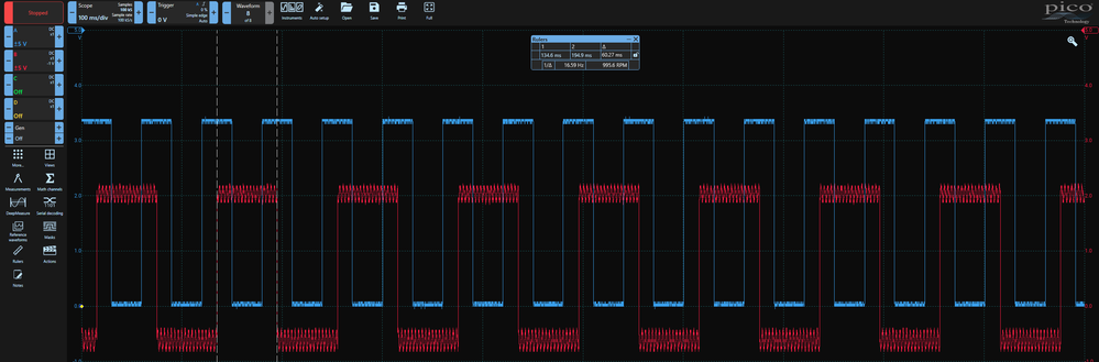

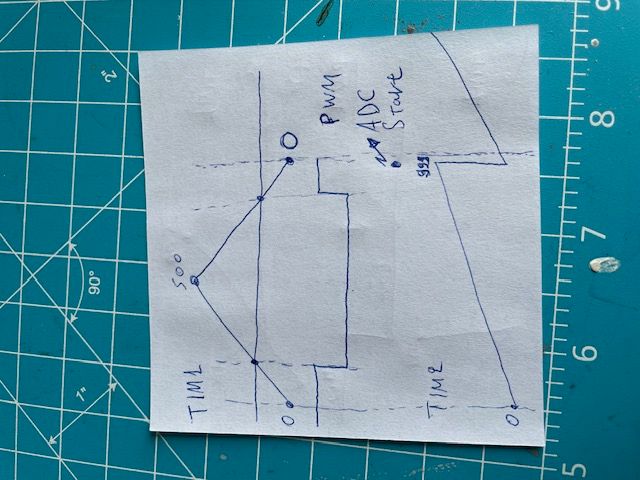

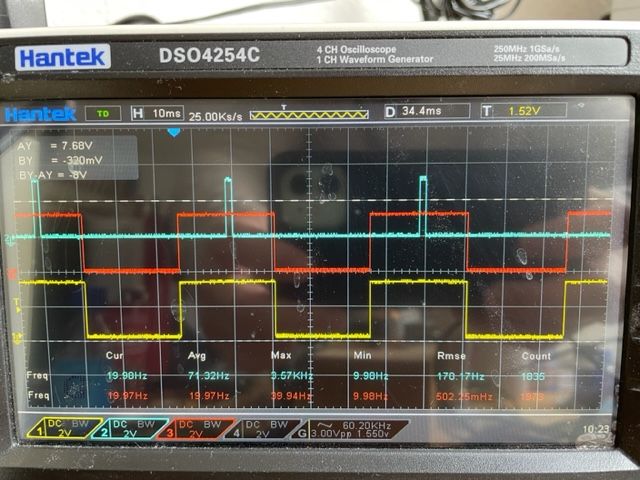

‎2023-06-02 2:40 AM - edited ‎2023-11-20 4:28 AM
I made the changes and is working BUT not properly. The timer 1 has ARR = 500 and the timer 2 as you said ARR = 999 but the ADC will be triggered when the PWM output is HIGH. (I use tim2 because tim3 is occupied).
But this is not what I want, because in FOC algorithm the ADC Conversion should be start when the Low Side of the Bridge is high.
The first build is how I understand this and the second of the oscilloscope, the blue is the ADC interrupt and the other are the two synchronized timers.
