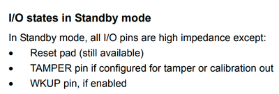

I am using stm32f302r8t6 microcontroller. In standby mode, the pins on port A are high, which should not be the case for the card I designed. For the stm32f302r8t6 microcontroller, I should keep one pin on port A low in standby mode.
In standby mode, almost all pins are high impedance. You need an external resistor to give the pin a defined state when in standby mode.
If it's the WKUP pin, you can configure it to have a pulldown.

Is there any way I can keep the a11 and a12 pin low? without making any hardware changes
for microcontroller stm32f302r8t6
Thank you for your answer..
They aren't WKUP pins, so no.
YBAYR.1
Yes, it is not wake up, I control the m0 and m1 pins of my Lora module.
