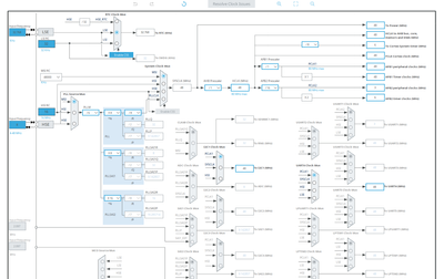

I have the following clock tree for STM32L471
I am using TIM2 as trigger for DAC, ADC1, and ADC2 at 2.4MHz. Clock frequency of TIM2 is 48MHz with a counter value of 19 and prescaler = 0.
With oscilloscope, I confirmed that the DAC is generating the signal at 2.4MHz sampling frequency.
The ADC1 and ADC2 are running in dual mode with single DMA channel. The following is the ADC configuration

The minimum time period of ADC can be 2.5+12.5 clock cycles = 15 clock cycles. The timer triggers every 20 clock cycles. But, at this frequency the ADC data is missing every other sample. To get all the expected samples, I have to run the timer with period of at least 28 clock cycles. What am I missing? How can I get the ADC data for every 20 clock cycles?

Hello @kasarghu
This seems to be related to the synchronization between the timer trigger period and the ADC conversion time in dual mode with DMA; when using dual ADC fast interleave mode, the two ADCs alternately convert the same channel and the time between two successive samples is 7 ADC clock cycles.
So, if your timer triggers every 20 clock cycles, but the ADC conversion (including sampling and conversion) takes 15 cycles, the timing doesn’t line up perfectly, on top of that, DMA adds some extra delay for transferring the data.
What can happen is that the timer triggers again before the DMA has finished moving the previous conversion data. This mismatch causes the problem you described.
To fix this, you need to match the trigger period with the dual ADC interleave mode timing. The timer period must be at least the sum of these times (15 cycles + DMA latency)
Hope that helps!
That makes sense for interleave mode. But, I am using dual ADC regular simultaneous mode with full-word size MDMA (unless I made mistake in configuration somewhere).
According to the RM0351 document, 'Figure 132. DMA requests in regular simultaneous mode when MDMA = 10', both channels together should take 15 cycles + DMA latency. Could you please point me where I can get some more information on estimating DMA latency?
Thank you.
Hello again @kasarghu
you can refer to AN4031 on how to predict DMA latencies (section 3), with an example of ADC to SRAM DMA transfer (section 3.2.1), to get an idea on how to estimate globally as the example is applicable on F4 not L4.
