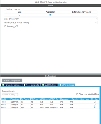

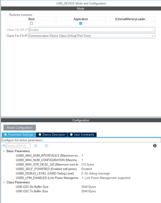

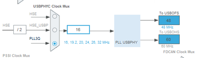

Hey, we have purchased the Nucleo board H7S3L8-B02. We always run in a timeout during USB core reset. This problem seems quite popular with multiple forum posts. However we still didn't manage to get it to run. I will give a set by step explanation of what we've done. Maybe someone catches the mistake. We made all of our settings in "Application", none in "Boot".
  • USB_OTG_FS settings:USB_OTG_FSUSB_OTG_FS
  • Middleware CDC settings:
CDCCDC

  • Clock settings (automatic by IDE)
CLKCLK

  • usbd_conf.c
void HAL_PCD_MspInit(PCD_HandleTypeDef* pcdHandle)
  RCC_PeriphCLKInitTypeDef PeriphClkInit = {0};
  if(pcdHandle->Instance==USB_OTG_FS)
  /* USER CODE BEGIN USB_OTG_FS_MspInit 0 */
  /* USER CODE END USB_OTG_FS_MspInit 0 */
  /** Initializes the peripherals clock
    PeriphClkInit.PeriphClockSelection = RCC_PERIPHCLK_USBOTGFS;
    PeriphClkInit.UsbOtgFsClockSelection = RCC_USBOTGFSCLKSOURCE_HSI48;
    if (HAL_RCCEx_PeriphCLKConfig(&PeriphClkInit) != HAL_OK)
      Error_Handler();
  /** Enable USB Voltage detector
    HAL_PWREx_EnableUSBVoltageDetector();
    __HAL_RCC_GPIOM_CLK_ENABLE();
    /**USB_OTG_FS GPIO Configuration
    PM14     ------> USB_OTG_FS_VBUS
    GPIO_InitStruct.Pin = GPIO_PIN_14;
    GPIO_InitStruct.Mode = GPIO_MODE_INPUT;
    HAL_GPIO_Init(GPIOM, &GPIO_InitStruct);
    /* Peripheral clock enable */
    __HAL_RCC_USB_OTG_FS_CLK_ENABLE();
    __HAL_RCC_USBPHYC_CLK_ENABLE();
    /* Peripheral interrupt init */
    HAL_NVIC_SetPriority(OTG_FS_IRQn, 0, 0);
    HAL_NVIC_EnableIRQ(OTG_FS_IRQn);
  /* USER CODE BEGIN USB_OTG_FS_MspInit 1 */
  /* USER CODE END USB_OTG_FS_MspInit 1 */
