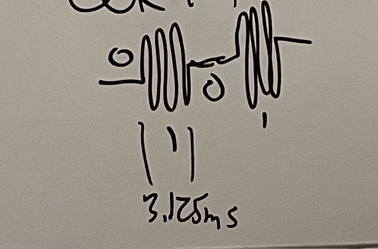

Hi everyone i'm new here with STM32 , I'm not really a programmer so I need some help.
my objective is generate sine wave with DMA DAC , I did that and I got my sine wave using FCLK with tim2 ( Iam using STM32F303K8 ) and now I want just to apply a delay for that sine wave for example 1ms on and 1ms off which mean 50% duty cycle , I read that I can apply another timer to create a delay with it , or directly call function HAL_Delay , thank you for your help

Not really explained very well.
Perhaps diagram the signals, input vs output.​
The sample rate can be drive by TIM.
Could you achevie the delay by controlling the phase of the data that is output to the DAC.​
zraci.1
Actually, I want to modulate my 100 kHz sinewave to 320 bits per second, and the modulated message has to be repeated 10 times. Basically, I want to reproduce that data signal .
