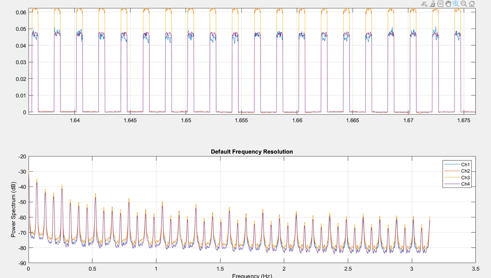

I am using cube mx for my design and I have some peripherals (ADC, Timer, I2S2, I2S3). I am making streaming by usb of some of them.
I want to stoop i2s modules when i am not using it becouse affect to other modules sampling rate.
By default Cubemx make this:

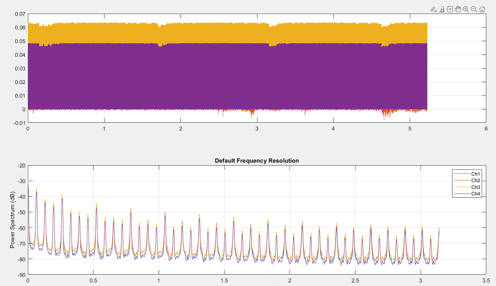

‎2023-04-18 7:08 AM - edited ‎2023-11-20 7:48 AM
Hi, the problem it is that there i a overstress in the process and the output is not correctly genrate or both module write inide the ame buffer.
Both module are writing in the same buffer so I2S is not stopped.
We can see that becouse hi and low signal are continuous. The higher part of the signal is from adc and the lower for i2s module. So I2S is not topped.
And this is the behaviour comment

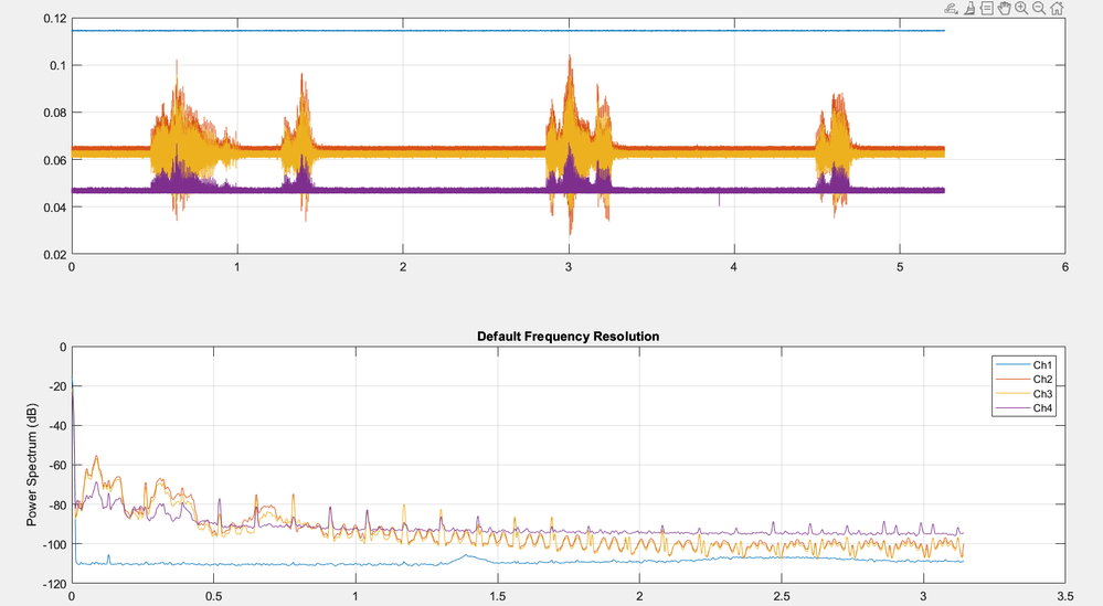

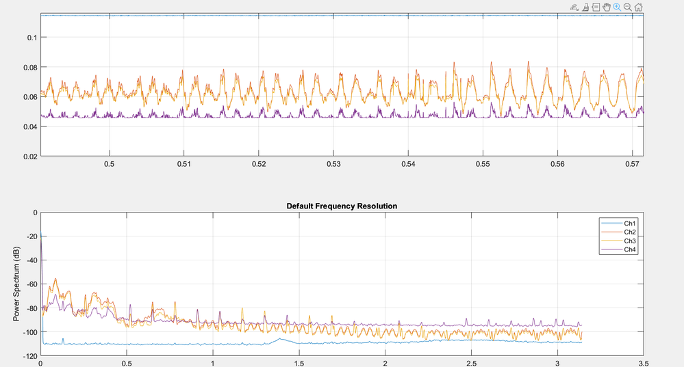

MX_GPIO_Init();
MX_DMA_Init();
MX_USART2_UART_Init();
MX_TIM2_Init();
MX_ADC1_Init();
MX_TIM3_Init();
MX_TIM1_Init();
//MX_I2S2_Init();
// MX_I2S3_Init();
In that case all signal came from ADC.

‎2023-04-18 7:31 AM
I don't quite understand what those pictures display.
Do you use I2S as receivers? Maybe you want to manually clear the I2S buffers after disabling them.
‎2023-04-18 7:42 AM
Ok, that pictures display 4 adc channel sampling at 48Khz for analog mics.
I can switch between I2S to Analog mics.
But if i use cubemx both modules are activated. Both DMA, from ADC (4channels) and for I2S3 and I2S2 tranfer info for same buffer.
If I stop I2S2 and I2S3 i think that only info form ADC dma must be transfer by streaming to pc.
