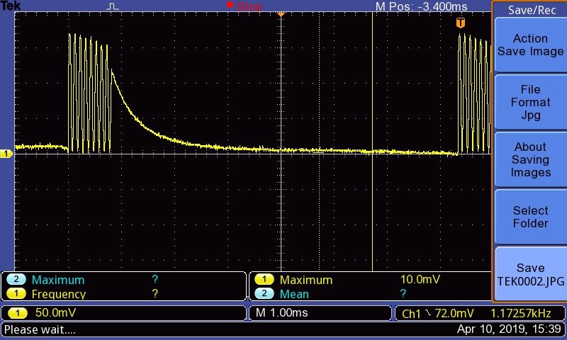

Hi, i am working on signal wave generation on the STM32L053 Discovery kit. I'd like to see the maximum frequency of signal generation (a sinus with 100 samples using DMA).
But the problem is : i cannot reach over ~20kHz, which is not even in the ultrasound domain.
The configuration of the peripherals must be wrong so, and I am using CubeMX to generate Low Layer code.
The system clock is PLLCLK at 32MHz (the maximum for AHB and APB1), and the DAC is triggered on the Timer6 trigger output.
I don't really understand the source of the problem. May someone can help me ? Thanks a lot !0690X000008AH1fQAG.jpg
Here is the code i used :
PS : the picture shows a problem i have when i change the SYSCLK frequency from under 4MHz to 8, 16 or 32 MHz. The sinus wave observed is at the right frequency but there are some timelaps where the potential is 0.

Hello!
"'d like to see the maximum frequency of signal generation (a sinus with 100 samples using DMA). "
According to DS (DocID025844 Rev 8), for max vcc the max Conversion Time gives 1,14 Msps, so with 100 samples per cycle, max theoretical freq will be about 11 KHz.
JFric
1.14 Msps is the maximum frequency for the ADC, the DAC is around 1Msps. Does it mean that for a sinus with 100 samples (the minimum for a correct waveform signal) it's impossible to reach over 10kHz?
I think it is really low.
But yet, i don't even manage to have a good sinus at 10kHz, i always have the problem mentionned on the picture.
Thanks !
JFric
Update :
After some tests, i manage to have some signal (with only 10 samples) at around 40kHz.
But when i want to change the HCLK to 8MHz, i have the issues mentionned on the topic.
More, i try to play with the Tim6.Period to fix the signal frequency. I cannot fix it under 0x8, or i'll have a constant signal.
As noted several times here, the settling time of the DAC output is in the range of several microseconds, resulting in a much lower effective bandwidth.
