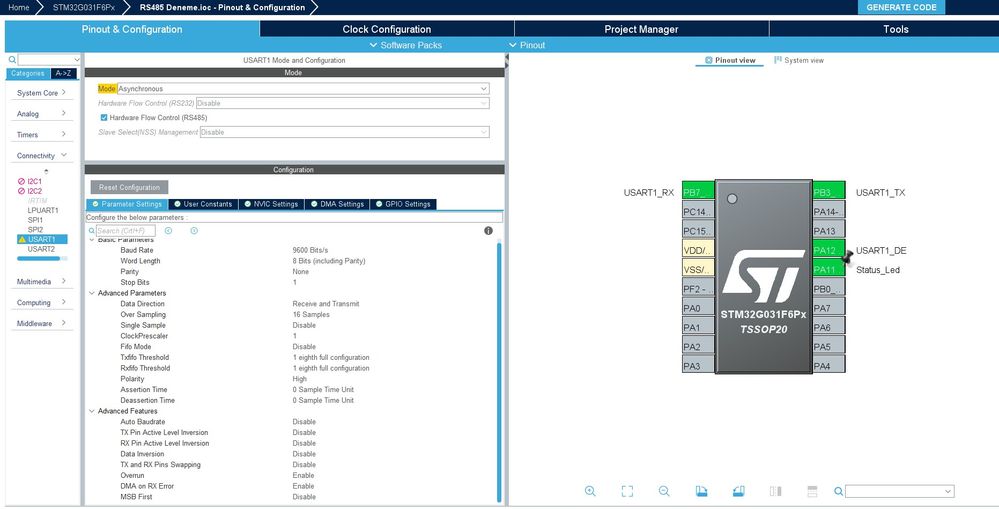

I am using STM32G031F6P MCU and i want to use UART TX with DMA in slave mode. But it is not working. RS485 line is always busy. I am using RS485 transceiver (SN65HVD37DR). If i use normal (not DMA) transmit mode, it is working. Code and cubemx project as follows;

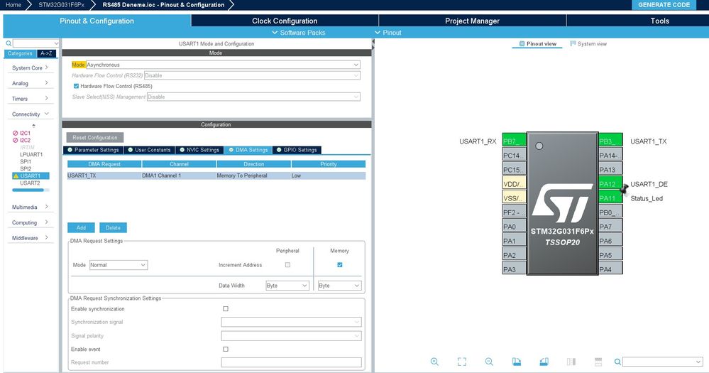

ENABLE the request event!

It didn't work. Definitely not working.

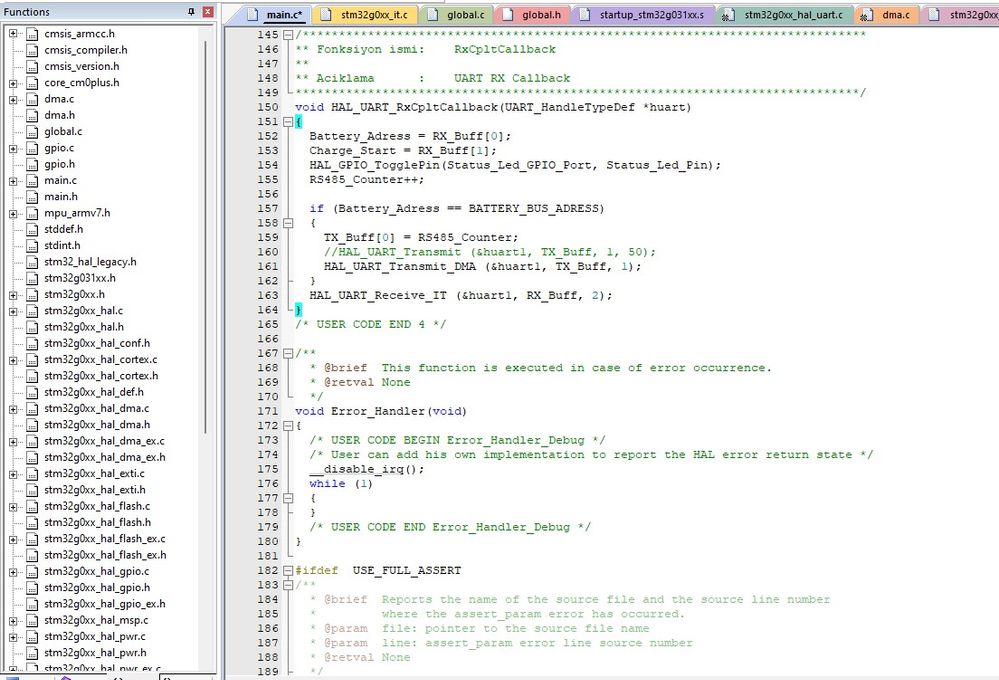

What does "RS485 line is always busy" mean? Is your CPU continuously transmitting? The more details you can provide the easier it is for people who don't know your system to help. Is your 485 bus 4-wire or 2-wire? If it is 2 wire, you will receive back what you transmit and I don't see your code accounting for that.
Which MAY explain your "always busy". HAL_UART_Transmit() returns AFTER the data has been sent. HAL_UART_Transmit_IT() and HAL_UART_Transmit_DMA() return as soon as the data has started to be sent. So with HAL_UART_Transmit_DMA() you are starting your receive before the TX data has been sent. If you have 2-wire RS485 then you WILL receive the same data you sent.

Bob S., I am using 2 MCU. STM32G431 (master) and STM32G031 (slave). I am using 4 wire bus RS485. Master is sending data every 10ms and slave responds. I don't continuously transmitting. But "HAL_UART_Transmit_DMA" keeps returning with "HAL_BUSY". I've watched a lot of videos, all basically doing the same inits. The configuration is not too complicated. Enable UART, set baud rate, activate DMA for TX, activate RX interrupt, write RX callback program and start. Thats all. But i still don't understand why it's not working.

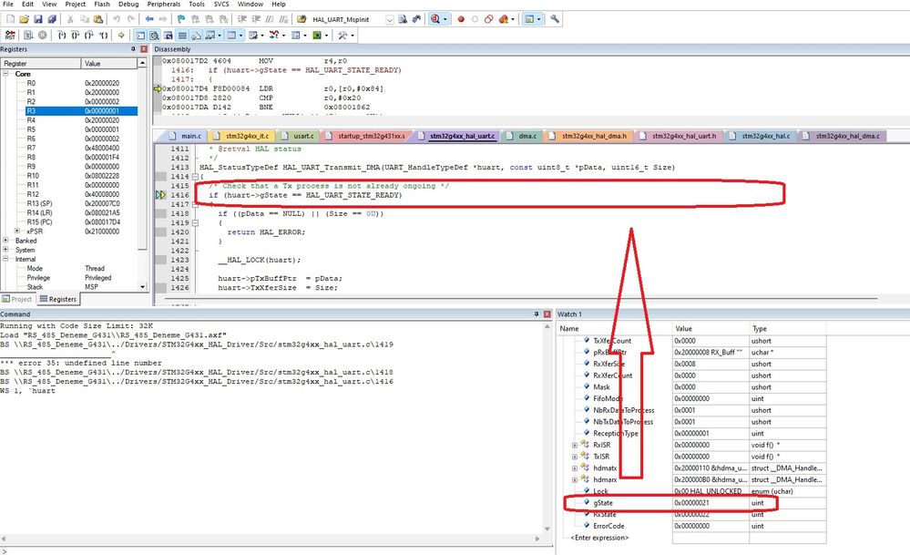

I still haven't been able to solve the problem. "HAL_UART_Transmit_DMA" is not working in "Normal" DMA mode. When I start the system, it sends only 1 byte of data. Then "if (huart->gState == HAL_UART_STATE_READY)" gState keeps getting 0x21 and returns with busy without sending.
0693W00000WJL8gQAH.jpgI am doing everything right. Could it be a problem with Cubemx?
