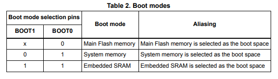

Hi piet t
Most of STM32 familly have BOOT0 pin and recent device have both BOOT0 pin and BOOTn user option bytes.
Check the reference manual of your device.
By default, if your firmware is programmed in FLASH (when using SWD) BOOT0 = GND
If BOOT0 = VDD you can enter in bootloader mode or relocate your code in SRAM.
KR
2018-03-03 11:03 AM
Here the example for STM32F405/407
2018-03-03 11:56 AM

2018-03-03 12:28 PM
Yes BOOT0 tied to 0V
