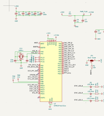

Hey, I'm having some issues with setting up clocks for my STM32F411CEU custom board with HAL.
Using PLLCLK from HSI ends up with Hardfault, around where RCC is being configured.
The only way I don't get hardfaults is:
1) if I set System Clock Mux to HSI instead of PLLCLK, but then it runs on 16Mhz which is way too slow for me.
2) I set System Clock Mux to PLLCLK and clock to something lower than 50Mhz.
I tried making an empty project, just initialization, and have the same issues. This happens on two different boards. I'm starting to suspect that JLCPCB sent me some fake ICs..
Shouldn't internal clock be the most "safe" and "should always work" option?
Been bashing my head on the table for few hours now, trying every possible combination but nothing works.
Thanks!
Care to share your schematic? VDDA shorted to VDD? VSSA shorted to VSS? Appropriate bulk and decoupling capacitors present? VCAP cap present?
If it's a board design issue, you won't be able to fix it in software.
kikibAuthor
January 4, 2025
Hey thanks for the help!
Here is the schematics:
One mention is that the HSE is not present. About the VCAP, I just realized that I did not place it. Could this somehow influence the RCC?
January 4, 2025
If VCAP is not present, the chip will not be able to run reliably, if at all. That is the issue. The capacitor on VCAP stabilizes/decouples the internal voltage rail. Without that, hard faults and other weirdness can be expected to occur, especially as the chip uses more power.
Getting started with STM32F4xxxx MCU hardware development - Application note
You can take a look at the design guide as well. But other than VCAP the schematic looks okay.

Flash wait states? Assume sweetspot around 24-27 MHz for Flash array, so one additional wait state at 50 MHz should be fine.
Issue with VCAP? Should be around 1.25V with around 4.7uF total capacitance across multiple pins
