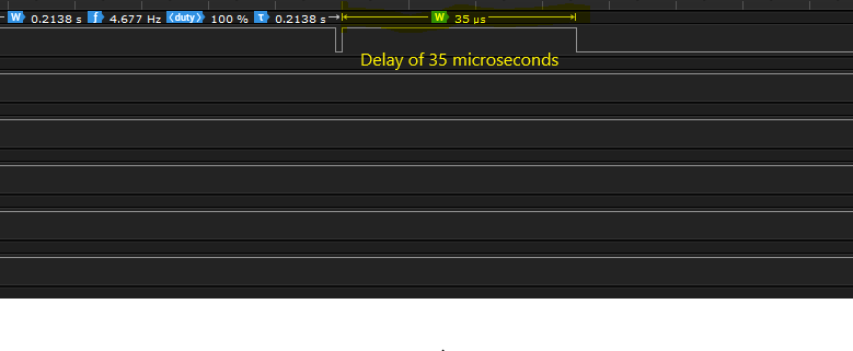

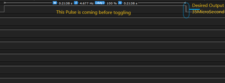

Hi, I am finding abnormal functioning of GPIO output while Toggling.I am getting Pulse of 0.2138s width everytime before my Desired Output(35microseconds) in STM32F401 Nucleo-64.
Please Support.

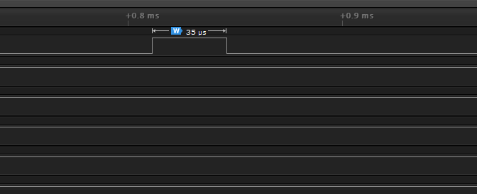

‎2021-04-21 7:59 AM

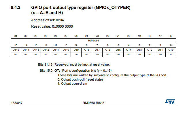

Problem Solved after Connecting 1 Kohm Pull Down Resistor .
But output Pin is selected as Push-Pull(reset state) in GPIO_OTYPER by default. Why Pin is Floating i don't Understand.
Thank you for ur Extended Support .
‎2021-04-21 8:59 AM
After reset, almost all pins including PA12 are set as Input in GPIO_MODER.
GPIO_OTYPER setting is pertinent only when the pin is turned to output, i.e. either set as Output in GPIO_MODER; or set as AF in GPIO_MODER and the controlling peripheral selected by GPIO_AFR set it as output (for example as when timer channel is set to Output Compare).
