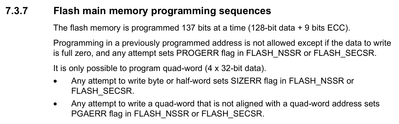

RM0456 Rev 3:
7.3.7 Flash main memory programming sequences
The Flash memory is programmed 137 bits at a time (128-bit data + 9 bits ECC).
Programming in a previously programmed address is not allowed except if the data to write
is full zero, and any attempt sets the PROGERR flag ...
hth

No amount of software will get around the fundamental hardware limitations of the flash. You get one shot. STM32U5 allows a write of all 0 as a special case, which is why writing that works.
Some chips allow re-writing of flash (STM32F4 series, for example), but this one does not. It was a design choice to prevent unwanted/unexpected behavior.
You don't need to load the entire 1 MB at once. Write granularity is in 128 bit chunks. I recommended reading the flash section of the reference manual, particularly "7.3.7 Flash main memory programming sequences".TDK_0-1764887350352.png

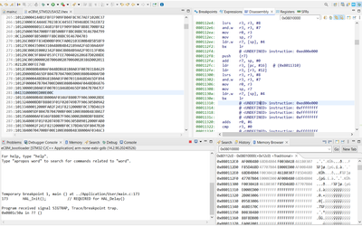

I attached a screenshot from STMCube.
It shows an Intel Hex file generated by the IDE. I used it to update my Application program. The result was a corrupted program. We typically used Intel Hex files with our basic BootLoader to update our code in the field. This won't work any more. What is the STM solution for updating code?
I don't mind the 16 byte block write, but preventing block re-writes with the ECC bits was a realy, realy, realy bad idea. What were you guys thinking?
Well, let's think about it objectively. For each flash page, the ECC bits are basically a hash of the data. Writing half the flash page will change the ECC bits to a basically random value. Writing the other half would change them to a different random value. But flash can only be written once. The ECC bits are in flash, part of the same flash they hold the ECC of, they're not some in some other NVRAM that can change at will. Can't change 0s to 1s.
It's not so much an idea or decision but a logical consequence of the fundamental hardware limitations of flash.
There are chips without ECC bits that let you write flash multiple times (STM32F4 series for one) if you don't want that behavior. ECC has benefits and drawbacks
The real issue here is the bootloader is not writing the entire flash page at once. That is a solveable problem and will fix the limitation you're running into. Preprocessing the HEX file could work, or doing some minimal processing in code to ensure a particular flash page is only written once.
You can normalize the .HEX file on the generation side, to ensure ordering, and FLASH line width.
You can buffer in RAM to ensure it meets the memory implementation goals. ie Folding multiple lines so you can write blocks of 16 or 128 bytes.
You can use binary forms, which is significantly more space efficient on the store medium, or transfer.
