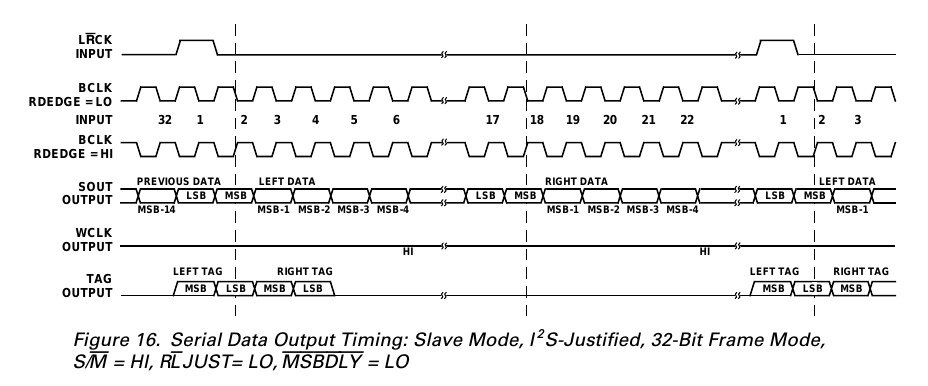

hello everyone
i have adc ad1877, configured as in picture- Mark as New

Perhaps you have just locked out yourself.
Check the relevant supply voltages on the board, and if o.k., try a mass erase with the Flash Loader Demonstrator, after booting it into system bootloader. There are several threads about this procedure here ...- Mark as New

Whatever...
In adc datasheet says that reset pulse should be made synchronous to clkin (mcko) . How to make it? By using some interrupt or what?- Mark as New
‎2014-04-05 8:32 AM
Not really. It says you should do this if you have more than one ADCs and want them all to leave the reset state at the same time. However, I still can't understand the fuzz about a 28-pin, 5V device. Perhaps the signal levels (3.3V <--> 5V) are part of your problems ...

Maybe, next time i'll try ad1871, it has independent power supply for i/o which can be powered from 3 volts
‎2014-04-06 6:19 AM
Seriously, I would consider this 3.3V/5V difference as possible source of your problems.
While the STM32 pins might be 5V tolerant and even read signals correctly, the output signals to the ADC might not reach the L/H theshold. That is a perfect recipe for spurious trouble misbehavior of the ext. device, and lots of new grey hairs. Consider level shifting circuitry, or rather another ADC.
