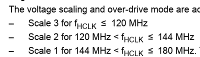

First set scale to 1:
If not working with your HSE crystal, just set (ioc Mx edit) to HSI and try connect debug then.

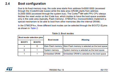

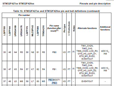

Hello
Try to pulldown PB2 pin or connect it to Gnd, it seems to be BOOT1.
Datasheet:
Ref.manual:
Br JTP
