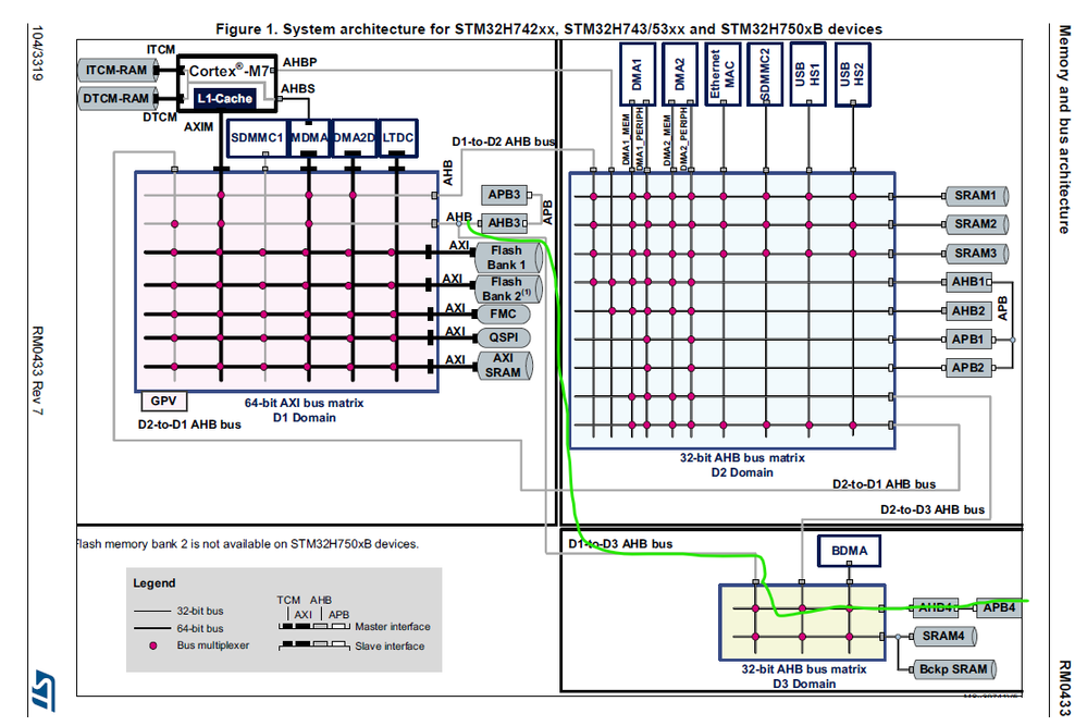

I need to service an external watchdog when a flash sector is being erased. The sector being erased is in the same flash bank where code is executed from. Before I try to jump and run from RAM I had a few questions.
Where is flash stall discussed in the reference manual?
Given the chip architecture, is there any issue with toggling a pin on Port G when a sector erase is ongoing? In other words, is the AXI bus matrix stalled during a flash erase?
Thanks!
No, flash erase alone is not causing bus matrix stall.

Thanks for the responses. What is curious is on a previous version of the software with the exact same hardware, the external watchdog strobes were occurring on the pin during a flash sector erase. We moved to new firmware including a new HAL and now there is a dead time of 848 ms.
‎2022-03-24 9:01 AM
Anyway, you're going to run from RAM or from other bank in order to prevent the stall.
The sector size is not relevant here.
Have you tried this? Does it solve the problem?
‎2022-03-24 9:57 AM
No, but I wanted to check if anyone else ran into this problem where it used to work and now it doesn't. Also, I wanted to check if the AXI bus matrix is affected, because if it is then running from RAM will not work.

Follow up on this question. When we jump and run from RAM we are able to service the external watchdog. Thanks for your help!
