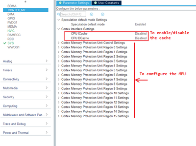

Most probably it's due to the cache. What if you disable it? or just configure the MPU on that region: Strongly Ordered/Or Device?

In CubeMx. All is in Cortex_M7 menu:

Caching at an address level look at ConfigMPU() code examples. Not really expecting the NAND region to be cached/cacheable,
Not much in the way of part# and code to see what might be going astray..
As MPU example
void MPU_Config(void)
  MPU_Region_InitTypeDef MPU_InitStruct;
  /* Disable the MPU */
  HAL_MPU_Disable();
  /* Configure the MPU as Strongly ordered for not defined regions */
  MPU_InitStruct.Enable = MPU_REGION_ENABLE;
  MPU_InitStruct.BaseAddress = <Put your start address of the memory>;
  MPU_InitStruct.Size = <Put your region size>;
  MPU_InitStruct.AccessPermission = MPU_REGION_NO_ACCESS;
  MPU_InitStruct.IsBufferable = MPU_ACCESS_NOT_BUFFERABLE;
  MPU_InitStruct.IsCacheable = MPU_ACCESS_NOT_CACHEABLE;
  MPU_InitStruct.IsShareable = MPU_ACCESS_SHAREABLE;
  MPU_InitStruct.Number = MPU_REGION_NUMBER0;
  MPU_InitStruct.TypeExtField = MPU_TEX_LEVEL0;
  MPU_InitStruct.SubRegionDisable = 0x0;
  MPU_InitStruct.DisableExec = MPU_INSTRUCTION_ACCESS_DISABLE;
  HAL_MPU_ConfigRegion(&MPU_InitStruct);
  /* Enable the MPU */
  HAL_MPU_Enable(MPU_PRIVILEGED_DEFAULT);
You need to fill in:
