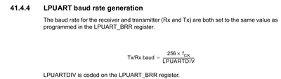

BRR seems wrong. See formula in the RM. You're setting it as if there are no fractional bits. Should be 256x what you have.
UE should be set before TE and RE.
Consider setting it up with HAL/CubeMX to see what the proper initialization settings and register values are.

Thank you both @Tesla DeLorean and @TDK, following both of your advice let me to getting some kind of input! My updated LPUART initialization code:

  LPUART1->BRR = ((256 * SystemCoreClock) / 9600);

And the updated code that sends a character (note that I've changed this to send a constant char on button press):
if(gpio_read(BTN_PIN) != 0) {
    gpio_write(LED_PIN, true);
    LPUART1->TDR = 'h';
    while(!(LPUART1->ISR & USART_ISR_TXE_TXFNF)) {};
} else {
    gpio_write(LED_PIN, false);
Upon starting screen on my computer the same way as before, I get a stream of ">" characters whenever I press the button on the board. I tried changing the char sent by the board to 'r', which changed the character appearing in the terminal to a stream of "�" preceeded by a single "0". I thought this was due to a mismatch between the frames that the tty was expecting and what the board was sending, so I fiddled with stty options by "stty -F /dev/ttyACM0 -cstopb -parenb -clocal cs8". This sets the tty to expect the same as the default LPUART registers - 1 stop bit, 8 data bits, no parity bits. This didn't change anything, however :) I'm left thinking that my baud rate must still not be set correctly, but I cannot see what would be wrong (after correcting the error that @TDK pointed out).
