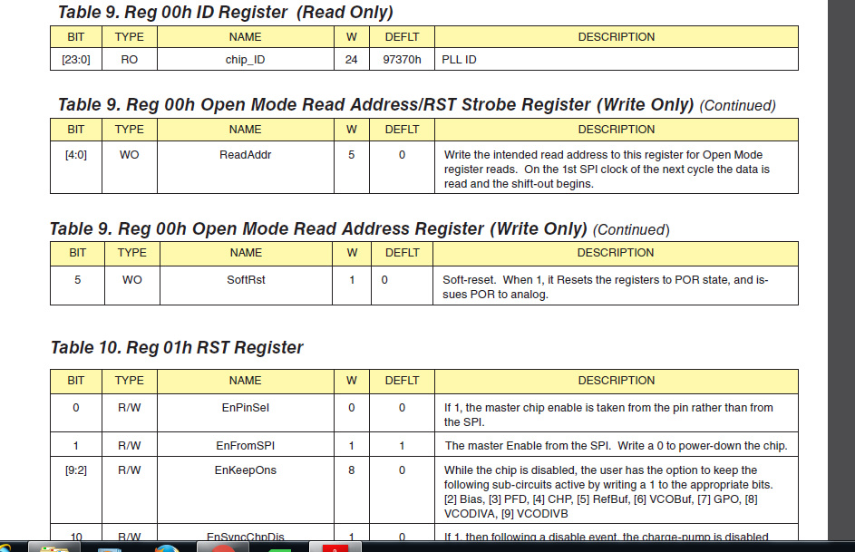

The HMC Mode protocol for the serial port is designed for a 4 wire interface with a fixed protocol featuring
a. 1 Read/Write bit
b. 6 Address bits
c. 24 data bits
please need yout help on how to send >16 bit data packet that include in above format

‎2020-03-31 1:41 PM
I took a quick look into the user guide ( https://www.analog.com/media/en/technical-documentation/user-guides/140-00074-00_operating_guide.pdf )
and it looks like the reads and writes are 32-bit. The last bit of command is just "don't care". And when reading, the bits after the address bits are "don't care" as well.
The 3 last bits returned while sending the read address byte just are the first bits of data. The previous ones are lock detect signal.
‎2020-04-01 1:17 AM
@turboscrew​ i know the size of the data is 32 bit where 1 bit r/w 6 bit address 24 bit data and last bit dont care. but how to send data in SPI i dont know.. i mean if u could provide me with some info. i just want to write the data.. currently not focusing on read operation. can u help with example where u send address + data on same clock in SPI.
‎2020-04-01 11:03 AM
