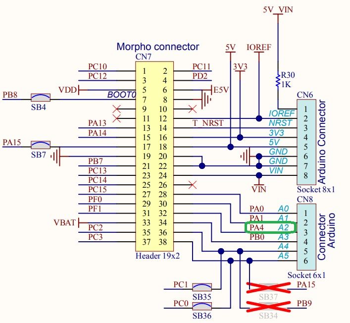

PA4 is connected to Arduino Rail A2 pin
If you drive pin high/low as a GPIO does that work?
According to the schematic it's directly connected to the IC, so no solder bridges or anything in the way.
DTorn.1
Excuse me! There are no jumpers. Connected to pin A4(A2 - CN8). SB37 and SB34 were not installed at the factory
