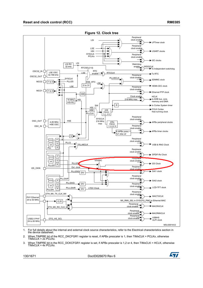

‎2022-10-17 6:54 AM
Make sure the SPI/I2S module has a valid clock configured in RCC.
If in doubts, read out and check/post RCC and SPI/I2S registers content.
‎2022-10-18 1:49 AM
As per the cubemx the clock configurations are done as follows
PeriphClkInitStruct.PLLI2S.PLLI2SN = 50;
PeriphClkInitStruct.PLLI2S.PLLI2SP = RCC_PLLP_DIV2;
PeriphClkInitStruct.PLLI2S.PLLI2SR = 2;
PeriphClkInitStruct.PLLI2S.PLLI2SQ = 2;
PeriphClkInitStruct.PLLI2SDivQ = 1;
PeriphClkInitStruct.I2sClockSelection = RCC_I2SCLKSOURCE_PLLI2S;
Still i could not able to transmit the data
‎2022-10-19 10:26 AM
SAI peripheral is the recommended choice for audio protocols instead of SPI/I2S peripheral.
