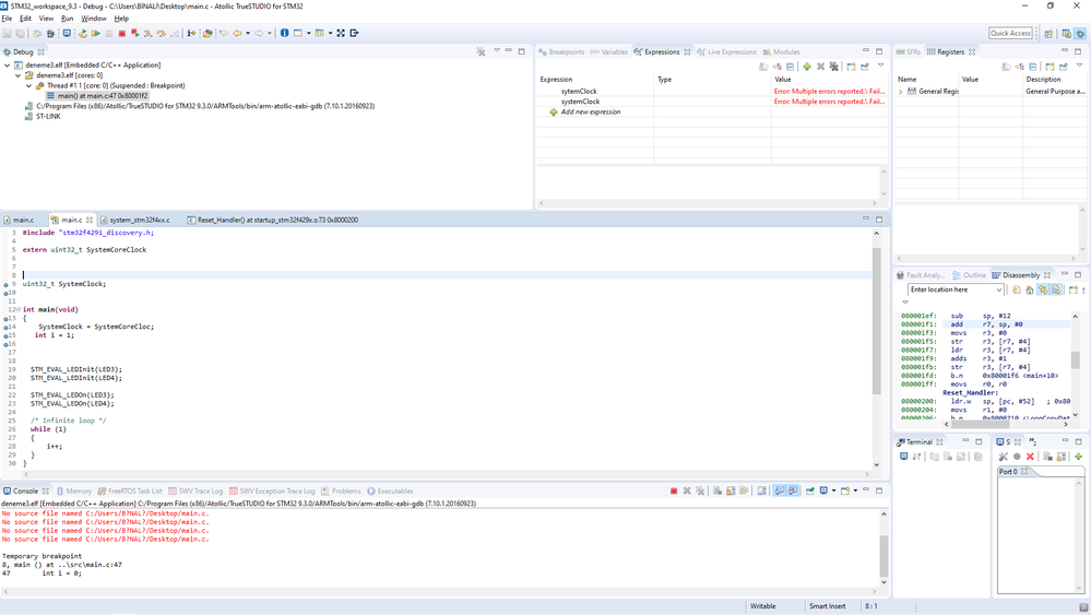

Hello, I am getting an error and I couldn't find the solution please help
Sözde.11
Can't find a source file at Can't find a source file at "C:\Users\B\335NAL\335\Atollic\TrueSTUDIO\STM32_workspace_9.3\deneme3\src\main.c"
Locate the file or edit the source lookup path to include its location.
The error I got in the compilation process is written above, the card I used is STM32F429I-DİSCOVERY development board.

Your username contains weird characters after B and L:
0693W000007CmO8QAK.pngMove the project to a path that contains only ascii characters and no spaces.
