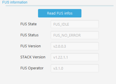

I have Stm32wb55Cgu6 board from from WeAct, With default FUS (V1.2) and BLE stack everything was okay. But when i upgraded the FUS 2.0 and newest BLE stack Full 1.22.1 . the Upgrade was successful, But I didn't got any Bluetooth connection for same code.

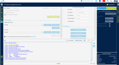

So I decided to delete the stack and install 1.19.1 old stack with FUS 2.0, but i cant, it shows "Warning: FUS-STATE_IMAGE_NOT_FOUND". I also get the same image when i try to change The FUS version itselt to 1.2.
Now neither I can Upload any version of FUS nor any BLE stack. I also used USB DFU Mode none can erase and download FUS or BLE stack at sector 0. The application just hangs up.
Im using  STLink Programer V3 Set.
I also tried mass erase and try to download the FUS and stack again and it wont work.
I have checked after mass erase there is no value at FUS start address by reading the flash, yet shows FUS version.

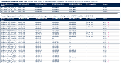

I think this is due to the known limitation on the FUS 2.0.0:
This is available under:
STM32Cube_FW_WB_V1.22.1/Projects/STM32WB_Copro_Wireless_Binaries/STM32WB5x/Release_Notes.html. So, could you please try to update your stack using the USB interface. Also, don't forget to click on the "Start wireless Stack" button after Stack and FUS installation.

Could you please try the USB mode using the STM32CubeProgrammer V2.19.0 and the .bin file available on the STM32CubeWB V1.22.1 for the stack file. Also, make sure to set the start address manually on the STM32CubeProgrammer according to the addresses available on this table:
