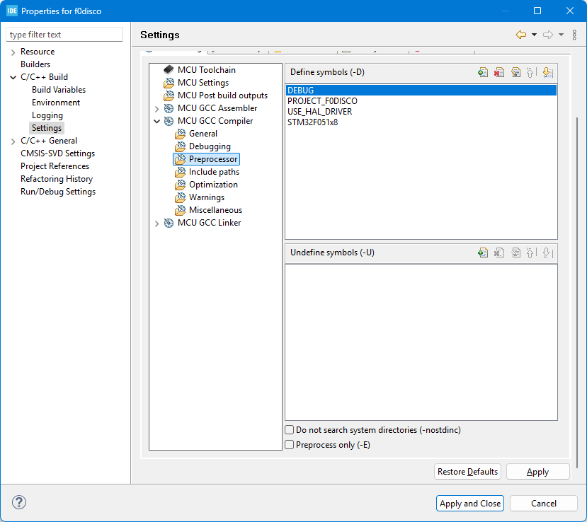

I have the same problem, trying to reverse engineer the AN4457 example for an H7xx MCU using with STM32CubeIDE. Currently my problem is that I need to "#define HAL_UART_EMUL_MODULE_ENABLED " in stm32h7xx_hal_conf.h, but there is not "USER CODE" field, so the define gets overwritten each time I change the IOC file.
You could just add it as a Defined Symbol in the Project Properties (Settings) ?
PS:
The above is from right-clicking the Project, and choosing 'Properties'.
You can also get to the Define Symbols setting by right-clicking an individual file, or a folder. I've not tried it myself, but I think that should let you apply it to just an individual file, or just a folder ...

Thanks for the workaround, that is a good idea. However, I found that the #define only triggers an #include in the stm32h7xx_hal_conf.h file to activate the module. Since I do not understand how to correctly integrate additional code (i.e. the STSW-STM32156 firmware package) as a module, I decided to give up on this and just implement a user-code solution along the lines of AN4457. A firmware package for the IDE toolchain would nonetheless be great to have.
