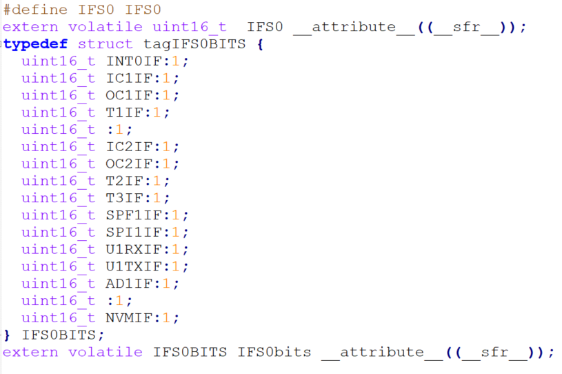

Having recently started with STM32 I am keen to get into programming in closer detail. Where can I find the "h" file defining the register list structure and the bit names as defined in the reference manual for the STM32F401RE ? see PIC24F32KA304 example
