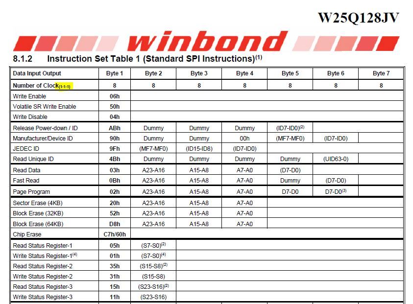

Yes, I'm sure I've enabled the QPI mode. And I can use normal read and check (in QPI mode) the status, and it works well. But it seems the auto-polling function won't work in this mode. My chip is w25q128jv.
February 8, 2021
Hi @diverger​ ,
I found different info that you may want to check: according to the W25Q128JV datasheet, the read status register is only in standard SPI mode (1-1-1).
For more details, please check the W25Q128JV datahseet , in sections:
  • 8.1.2 Instruction Set Table 1 (Standard SPI Instructions)
  • 8.1.3 Instruction Set Table 2 (Dual/Quad SPI Instructions)
  • 8.2.4 Read Status Register-1 (05h), Status Register-2 (35h) & Status Register-3 (15h)
Imen

Hi @Imen DAHMEN​ Thanks for your patience.
Actually I'm not very sure if my chip is W25Q128JV or W25Q128JV-DTR (the chip is on a EVAL-board, and I need ask for the BOM to get the exact part number), the latter one apparently supports this command in QPI mode. And I can read the JESD SFDP table, it shows it support DTR, so my chip is very likely the latter one. And another evidence is, I can read back the status register in QPI mode (using 4-4-4 line pattern) indeed. As you know, auto-polling is just making the read-and-check more 'auto', they use same command.
Thanks.
Imen.DBest answer
February 10, 2021
I confirm that W25Q128JV-DTR supports QPI mode.
Can you try your indirect mode configuration (4-4-4) and add 1 or 2 Dummy-cycles ? for example: qspi_cmd->DummyCycles = 2;
Then, please keep me informed about your progress on this.
Imen
