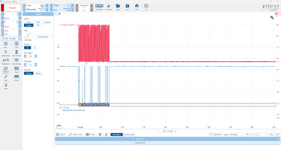

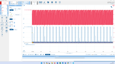

‎2024-06-04 1:47 AM - edited ‎2024-06-04 1:48 AM
Hi Evangelist,
Calling a write function to write about 6 bytes. But it keeps sending contineously a lot of data.
HAL_StatusTypeDef ret = HAL_I2C_Mem_Write_DMA(&hi2c1, (20 << 1) | 0, 4, 1, &to_reg[0], 6);

‎2024-06-04 3:25 AM - edited ‎2024-06-04 4:53 AM
Hi There,
Yes HAL_I2C_Mem_Write works for me.
I removed the I2C pins from the .ioc file and added back again without renaming the label name on SDA and SCL.
Now i can see that it can send exactly the 6 bytes. But looks like there is no NACK and SCL is pulling low. Iam connecting to RM3100 device.
‎2024-06-04 4:55 AM - edited ‎2024-06-04 5:38 AM
Hi Andrew,
I found the solution from this link:-
I need to add below code and enable the I2c event interrupt. Seems working fine. But I need to tune my code a little bit more.
void HAL_I2C_MemTxCpltCallback(I2C_HandleTypeDef *hi2c)
if (hi2c->Instance==hi2c1.Instance)
HAL_DMA_Abort_IT(hi2c->hdmatx);
void HAL_I2C_MemRxCpltCallback(I2C_HandleTypeDef *hi2c)
