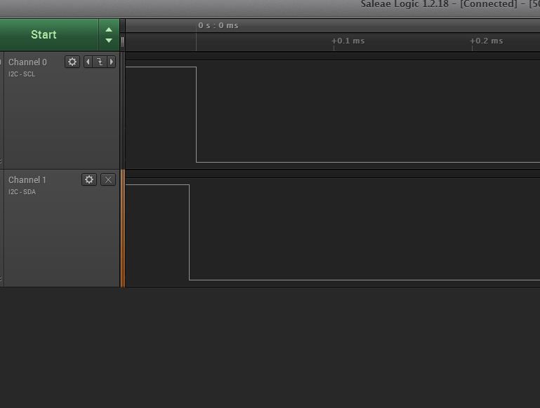

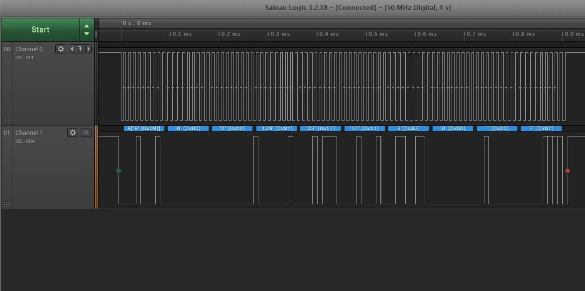

Hello
Having real issues with the I2C DMA HAL code ???
Is it buggy.... very likely from what i'm reading on the web or is there something I am not understanding ??
I'm simply trying to read data back from a i2c flow sensor with minimal interruption to the processor thus why trying to use HAL I2C DMA
when I use use NON DMA I2C code everything is great and works well
HAL_I2C_Master_Receive( &hi2c1, Sensor_Adr << 1 | 0x01, I2C1_DATA , 9, HAL_MAX_DELAY );
Yet when I use the HAL I2C DMA code its broken ????
HAL_I2C_Master_Receive_DMA( &hi2c1, Sensor_Adr << 1 | 0x01 , I2C1_DATA, 9);
this should work the same way the non DMA code work, but using the DMA hardware, but we can see it does not....
we can see it starts to initiate a DMA I2C session, but stops after dropping SDA & SCL line why ??????
It should continue to read back the data from the sensor the same way the Non DMA I2C code does. ??
Can someone please help and advise as I am totally lost, what am I missing or is there a bug, thank you in advance for any help

thanks for your reply, but sadly still no joy ?? SDA & SCL Lines still being held low and obviously messing up the communications to the sensor
here is my code now
/* USER CODE END SysInit */
 MX_DMA_Init();
 MX_GPIO_Init();
 MX_CAN1_Init();
 MX_CAN2_Init();
 MX_I2C1_Init();
 MX_I2C2_Init();
 MX_I2C3_Init();
 MX_SPI2_Init();
 MX_SPI3_Init();
 MX_USART1_UART_Init();
 MX_USART2_UART_Init();
 /* USER CODE BEGIN 2 */
 ms_tick1 = 100;
still SDA and SCL lines stay low ????

still having all major issues
1) I really don't understand any of this I2C HAL DMA ???
2) when trying to read the data back, the sda and scl lines drop low and that it..... WHY ??
3) it then messes up further i2C reads as the SCL & SDA lines are low
