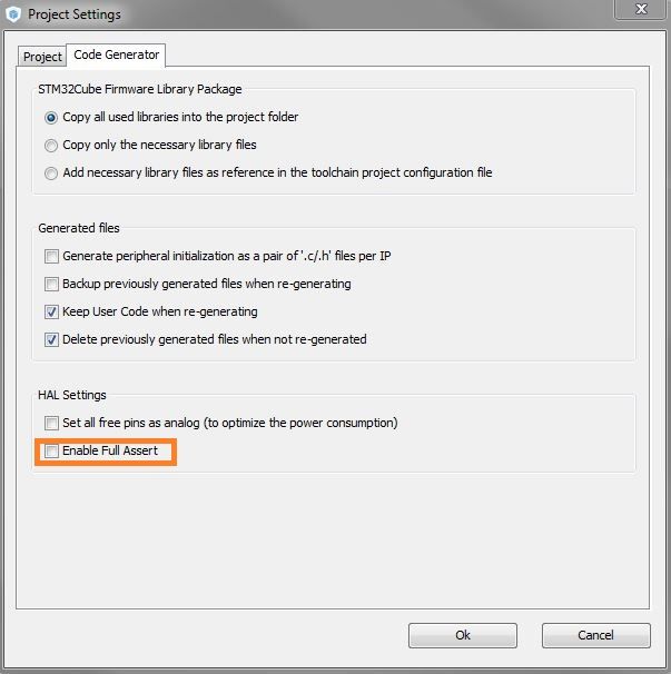

Posted on September 25, 2014 at 10:16
Hi Laurent,
In fact, theHAL_I2C_Mem_Read() API contains a check on the MemAddSize parameter. User needs just to activate the assert parameter macro USE_FULL_ASSERT by uncommenting the following line within the HAL configuration file stm32xxx_hal_conf.h:
/* ########################## Assert Selection ############################## */
* @brief Uncomment the line below to expanse the ''assert_param'' macro in the
* HAL drivers code
/* #define USE_FULL_ASSERT 1 */
This macro can be enabled also from the STM32CubeMX tool before generation the user code, by selecting: Project »Settings »Code Generator tab» HAL Settings» Enable Full Assert, as shown below: 0690X00000603JkQAI.jpg Cheers, Heisenberg.

Osto
Senior
Posted on September 25, 2014 at 22:38
I cant use the FULL_ASSERT because it has a bug when I use complex timers. The application enters assert during the Cube initialisation sequence. If I remoe the timers, my application will not run at all.
