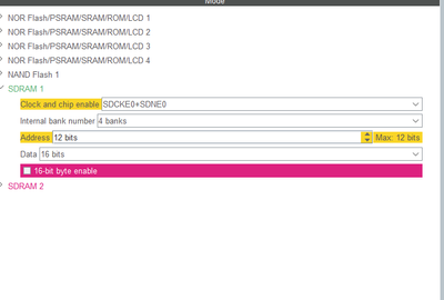

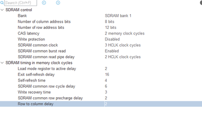

I'm working on a custom board with a STM32H723ZG. I'm also using external sd ram part IS42S16400J-6TL found here (https://www.digikey.com/en/products/detail/issi-integrated-silicon-solution-inc/IS42S16400J-6TL/2708625). I've followed the excellent sd ram tutorial here: https://community.st.com/t5/stm32-mcus/how-to-set-up-the-fmc-peripheral-to-interface-with-the-sdram/ta-p/49457 which was how I was able to determine the values in the stm32 cube IDE. The FMC init generated function runs without error (MX_FMC_Init which calls HAL_SDRAM_Init). I have posted the cube IDE set up below.

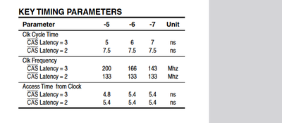

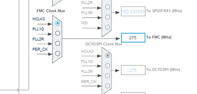

My FMC clock input is using HCLK3 at 275Mhz, but the sd ram common clock is 3 HCLK cycles, so this should put the sd ram clock at 91.66 mhz. I believe this is below the 110 mhz limit for my voltage range (3.3V).

| DataSheet Symbol | Datasheet value | CubeMx name | CubeMX value | |
| Tmrd | 2 cycles | Load Mode Register to Active Delay | ||
| TXSR | 66 ns | exit self refresh delay | 7 | |
| tRAS | 42 ns (min) | self refresh time | 4 | |
| trc | 60 ns | sdram common row cycle delay | 6 | |
| tDPL | 2 * clk (nanoseconds) | Write Recovery time | 3 | twr - tcd (5 -2) =3 |
| tRP | 15 ns | common row precharge delay | 2 | |
| tRCD | 15 ns | row to col delay | 2 |

I've solved the problem. When you generate fmc related files in cubemx, they can be different if your target is a ST board, vs just the chip. The following defines and sd ram commands were present in the discovery board, but were not being generated when I built for our custom board. Adding these in allowed me to see the clock signal (FMC_CLK) and then I was able to read sd ram
