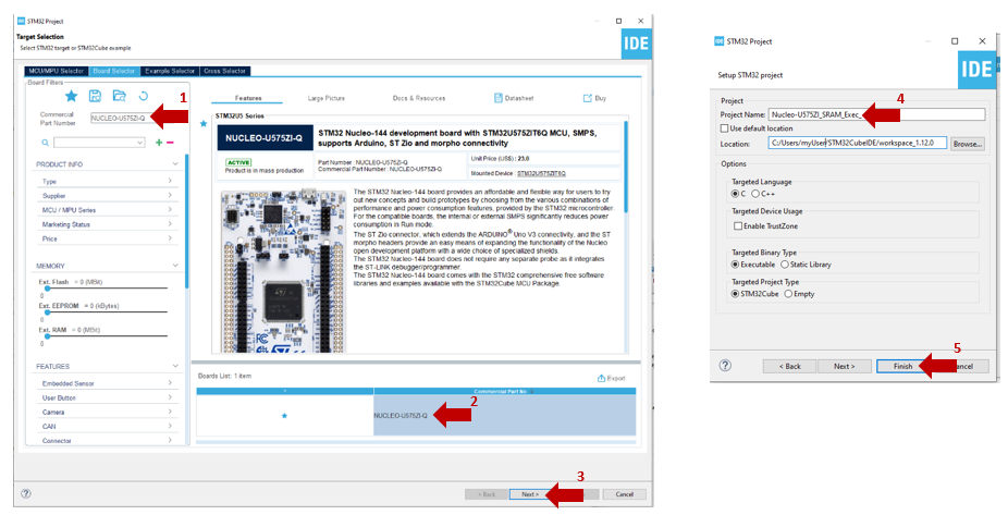

1. Run STM32CubeIDE and create a new STM32 project using NUCLEO-U575ZI-Q board (refer to the getting started with STM32 step by step in STM32 MCU Wiki.)
2. Name it as an example ‘Nucleo-U575ZI_SRAM_Exec’ and generate the project.

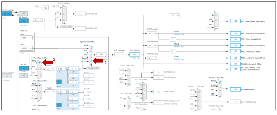

3. Leave all the STM32CubeMX configuration to the default value except:
  • Clock configuration from MSI and PLL to obtain HCLK = 160 MHz

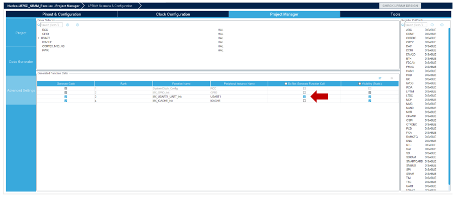

4. Do not generate the MX_USART1_UART_Init function call in the "Project Manager" tab.
5. Save the project and generate the code.

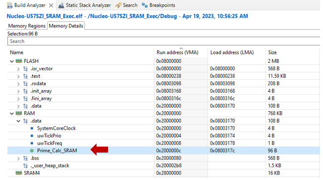

13. Build the project.
14.

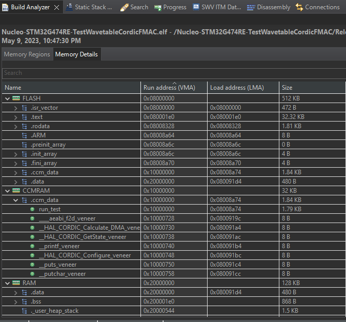

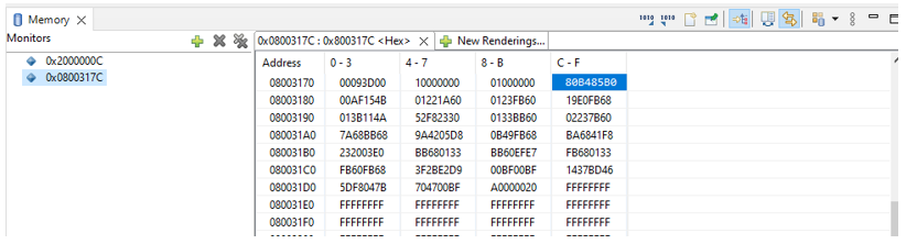

Locate Prime_Calc_SRAM symbol in Build Analyzer, this is the hierarchical representation of the map file generated during the linker phase.
The point here as described in step 12, the linker resolves the function from Flash address 0x0800317C and copies it at startup in SRAM1 at address 0x2000000C.
15. P
lace two breakpoints:
  • In Reset_Handler at line bl  SystemInit in startup_stm32u575zitxq.s
  • In Prime_Calc_SRAM() function at line primes_ram[0] = 1;

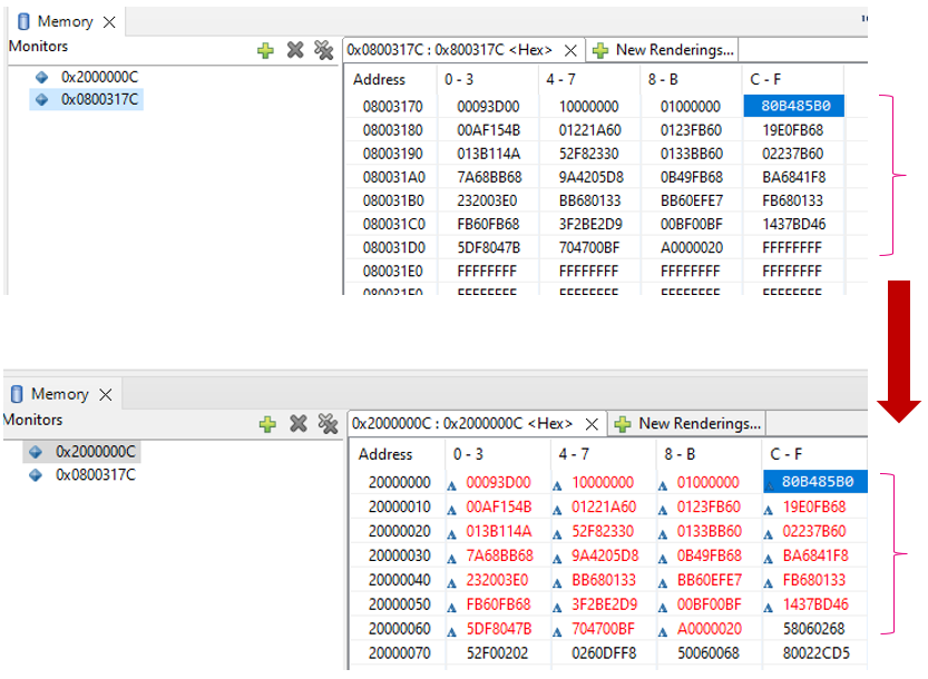

16. Start the STM32CubeIDE debugger. The first breakpoint halt the CPU in Reset_Handler: in startup_stm32u575zitxq.
17. Open Windows → Show view → Memory and monitors the address location in flash memory and in SRAM1 of the Prime_Calc_SRAM() function.
18.
We can see that the linker placed the function starting at 0x0800317C and with a size of 96 bytes, in the flash memory section.

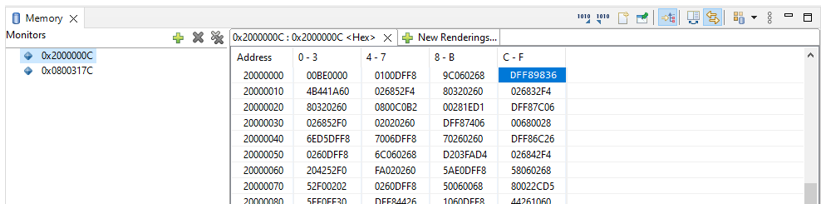

19. While the SRAM1 contains random data (or not allocated) at 0x2000000C address.

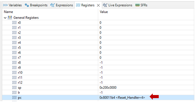

20. Check the Registers → General Registers watch expression, the PC counter is in flash memory.
That means that the code is executed in flash.
21. Resume (F8) the execution. The second breakpoint Halt again the CPU at the beginning of Prime_Calc_SRAM() function in main.c.
In addition, the 96 bytes of code related to the Prime_Calc_SRAM() function is copied from flash memory at 0x0800317C to SRAM at 0x2000000C.
The copy was done by LoopCopyDataInit: in startup_stm32u575zitxq.s

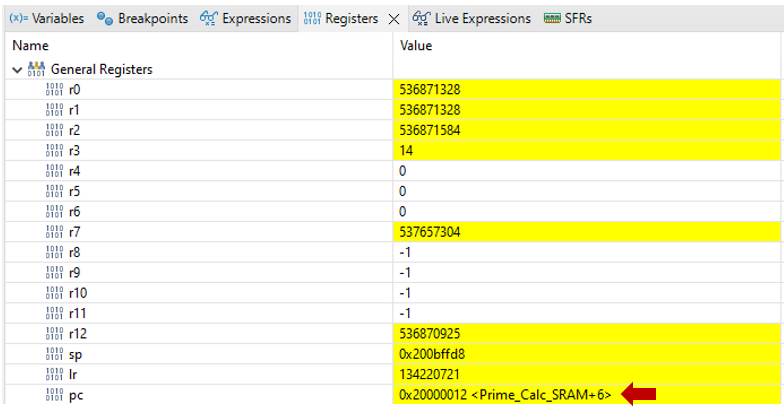

22. Now, check again the PC counter. The function is now executed in SRAM1.

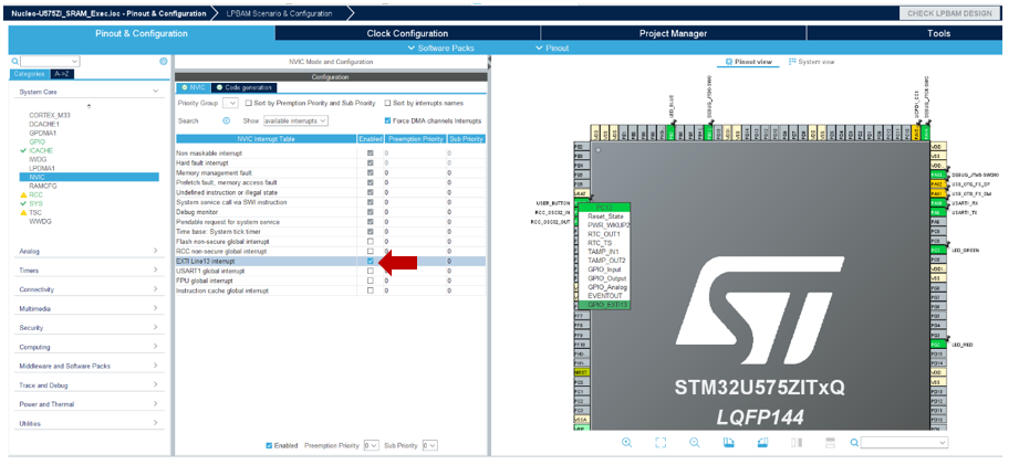

1. Open Nucleo-U575ZI_SRAM_Exec.ioc in order to configure an EXTI interrupts for the User button on the NUCLEO-U575ZI-Q board.
2. Open NVIC Categories and simply check EXTI Line 13 interrupt Enabled. Keep all the other existing configuration.
3. Save the project and regenerate the code.

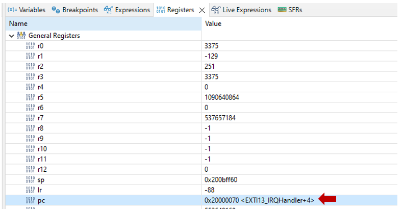

10. Rebuild the project, and run the debugger. Keep the breakpoint at the same line as step 5.
11. Press again, the User button (blue button) on the Nucleo board, the CPU is halted into EXTI13_IRQHandler().
12.Check the Registers → General Registers watch expression, the PC counter is at address 0x20000070.
That means that the interrupt handler function is executed in SRAM1.

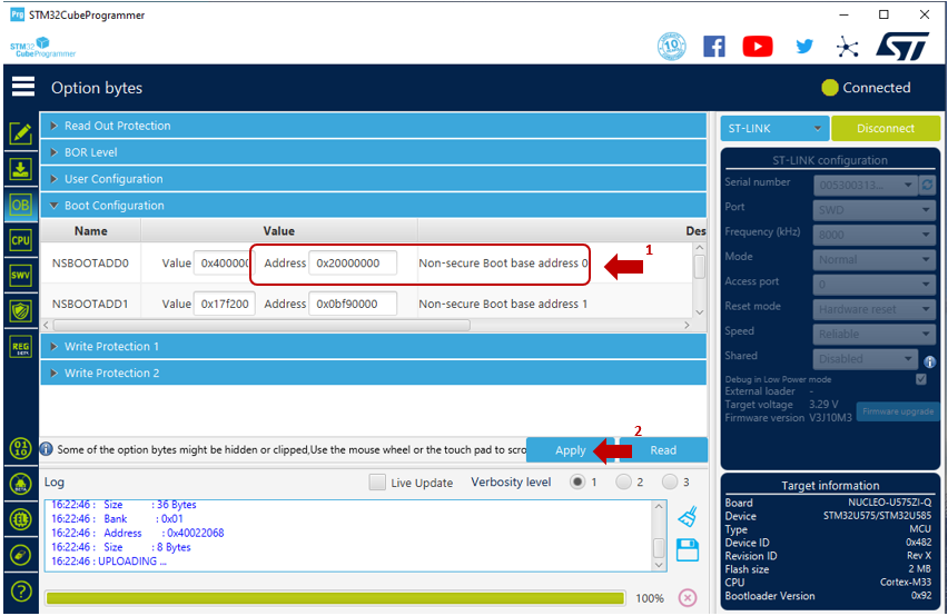

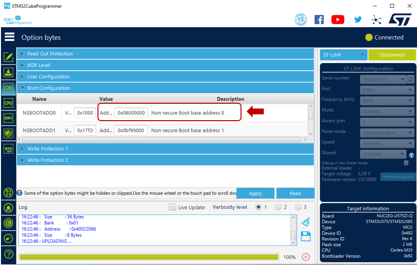

Case 3: Placing and executing an entire project in SRAM (code and interrupts)
This third part describes the steps to link and execute a full STM32 project in SRAM using STM32CubeIDE.
It is still based on the same project used in the previous steps.

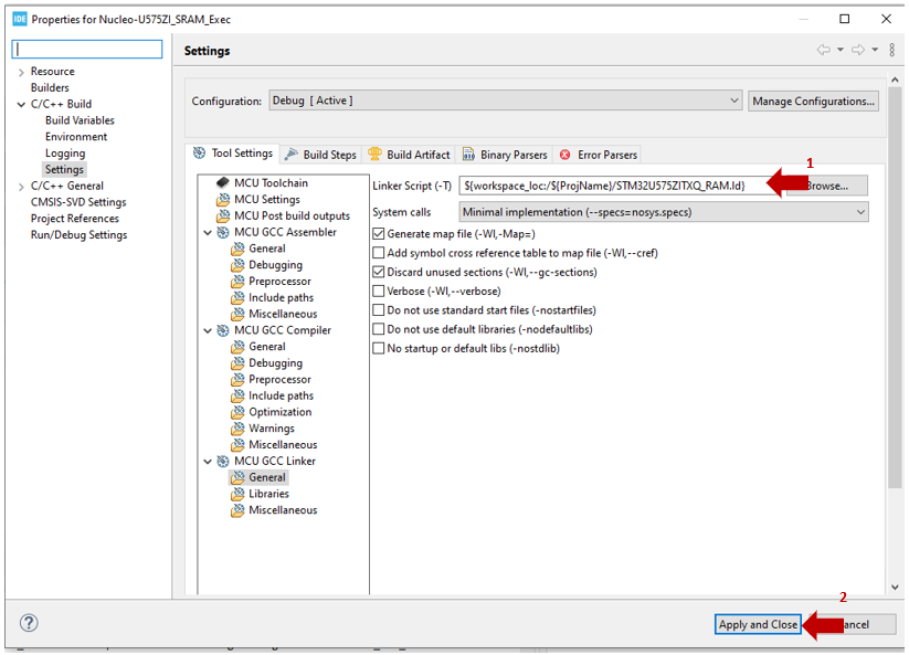

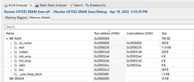

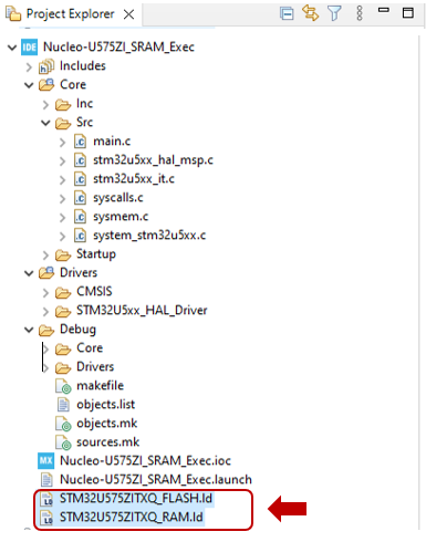

4. Check and locate in Project Explorer the linker file generated by CubeMX.
5. As explained in the first case, CubeMX generates two types of linker file.
  • STM32U575ZITXQ_FLASH.ld is related to defining all physical memory of the device, like flash memory and all SRAM bank, and to place all the symbols in these sections.
  • STM32U575ZITXQ_RAM.ld define only the RAM memory of the device (see below)
/* Memories definition */
MEMORY
 RAM	 (xrw)	: ORIGIN = 0x20000000,	LENGTH = 768K
 SRAM4 (xrw)	: ORIGIN = 0x28000000,	LENGTH = 16K
In this linker configuration all the symbols are placed in the memories definition, in this case in SRAM1 (0x2000 0000) and you can check the linker command >RAM of each SECTIONS.
Example for the .isr_vector (interrupts) and .text (Code) Sections.
/* The startup code into "RAM" Ram type memory */
 .isr_vector :
 KEEP(*(.isr_vector)) /* Startup code */
 } >RAM
 /* The program code and other data into "RAM" Ram type memory */
 .text :
 *(.text) /* .text sections (code) */
 *(.text*) /* .text* sections (code) */
 KEEP (*(.init))
 KEEP (*(.fini))
 _etext = .; /* define a global symbols at end of code */
 } >RAM
6. Open Project Properties, right click on Nucleo-U575ZI_SRAM_Exec in Project Explorer.
7. Go to C/C++ Build → Settings and select the Tool Settings tab.
8. Select MCU GCC Linker → General (see below)
9. Change the Linker Script (-T) path with the following: ${workspace_loc:/${ProjName}/STM32U575ZITXQ_SRAM.ld}
10. Apply and Close to save the new configuration.
11. Clean the project then rebuild it.
12. Check the Build Analyzer that provides an analysis of the new map file generated by the linker configuration.
The flash memory section is not present, and all the symbols are placed in SRAM1 (interrupt vector, code, and data.)

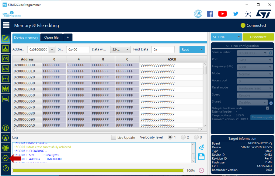

13. To be sure that the new project will be executed from SRAM1, we use STM32CubeProgrammer to perform a full chip erase of the flash memory.
14. Open STM32CubeProgrammer, connect to the board and select Full chip erase Icon on the bottom-left corner.
15. The flash memory is erased to 0xFFFFFFFF value.
16. Disconnect the Nucleo board from STM32CubeProgrammer.
17. In STM32CubeIDE, start the debugger and step over to check the same features as the case 1 and 2 as:
  • EXTI13_IRQHandler when User button is pressed.
  • The result of the Prime_Calc_RAM() function result.
  • The blue LED blinking.
All code is placed and executed from SRAM1 and can be debugged as long the NUCLEO-U575ZI-Q is powered on.

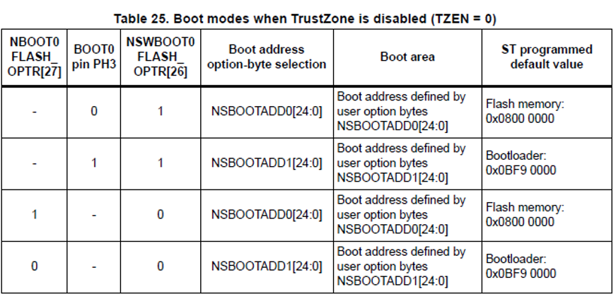

For the STM32U5 family, you must refer to RM0456, chapter 4 "boot modes".
The same chapter is also present for all other STM32 in their respective Reference Manual.
Table 25 in RM0456 explains the boot mode when TZ=0 (Nonsecure mode)
By default, on a new fresh STM32U5, the memory used for boot mode is the flash memory.
It depends on BOOT0 PH3 pin level, in our case, this pin is connected to VSS through a resistor.
We just need to change the NSBOOTADD0[24:0] defined by user option bytes, and configure the boot mode in SRAM1 address, to be aligned with our linker configuration.
21. Open STM32CubeProgrammer, and establish a connection with the board.
22. On the left, select the Option bytes icon.
23. Select Boot Configuration, you should see the NSBOOTADD0 field (see below)
24. Change the value of NSBOOTADD0 Address to 0x20000000. And click Apply to write the new option byte value in the flash memory of the STM32.
25. Observe the blue LED2, it blinks again. This is because a reset of the STM32U5 has been performed after the write sequence of the NSBOOTADD0. As the board was still powered on during this sequence, the contents of the SRAM1 are not lost, and the firmware can start the execution in SRAM1 again.

I gave it a go myself but couldn't get it working with a Nucleo-G474RE. What I tried was the following:
For the linker script, STM32G474RETX_FLASH.ld, hange the default:
MEMORY
 RAM (xrw) : ORIGIN = 0x20000000, LENGTH = 128K
 FLASH (rx) : ORIGIN = 0x8000000, LENGTH = 512K
to:
MEMORY
 CCMRAM (xrw) : ORIGIN = 0x10000000, LENGTH = 32K
Then also add:
/* Used by the startup to initialize ccm_data */
 _ccm_sidata = LOADADDR(.ccm_data);
 /* Initialized data sections into "CCMRAM" Ram type memory */
 .ccm_data :
 . = ALIGN(4);
 _ccm_sdata = .; /* create a global symbol at data start */
 *(.ccm_data) /* .ccm_data sections */
 *(.ccm_data*) /* .ccm_data* sections */
 *(.CCMRamFunc) /* .CCMRamFunc sections */
 *(.CCMRamFunc*) /* .CCMRamFunc* sections */
 . = ALIGN(4);
 _ccm_edata = .; /* define a global symbol at data end */
 } >CCMRAM AT> FLASH
Then add to the startup script startup_stm32g474retx.s:
.global	g_pfnVectors
.global	Default_Handler
/* MY MODIFICATION HERE */
.word	_ccm_sidata
.word	_ccm_sdata
.word	_ccm_edata
/* start address for the initialization values of the .data section.
defined in linker script */
.word	_sidata
/* start address for the .data section. defined in linker script */
.word	_sdata
/* end address for the .data section. defined in linker script */
.word	_edata
/* start address for the .bss section. defined in linker script */
.word	_sbss
/* end address for the .bss section. defined in linker script */
.word	_ebss
and:
/* Copy the data segment initializers from flash to SRAM */
 ldr r0, =_sdata
 ldr r1, =_edata
 ldr r2, =_sidata
 movs r3, #0
 b	LoopCopyDataInit
/* Copy the data segment initializers from flash to CCM SRAM */
 ldr r0, =_ccm_sdata
 ldr r1, =_ccm_edata
 ldr r2, =_ccm_sidata
 movs r3, #0
 b	LoopCopyDataInit
Then to call my function:
void __attribute__((section(".CCMRamFunc"))) run_test(void)
I even get the results visible in the STM32CubeIDE Build Analyzer:
_legacyfs_online_stmicro_images_0693W00000bjh78QAA.pngBut it doesn't run.
If I switch the code pragma back to:
void __attribute__((section(".RamFunc"))) run_test(void)
it's fine.
So I'm confused. What did I miss?
When I run it through the debugger, the second it calls my function run_test, it immediately hits the function:
void HardFault_Handler(void)
but I don't know why.

I fixed my bug. Everything above is correct except for the .s file, which is now:
 ldr r0, =_sdata
 ldr r1, =_edata
 ldr r2, =_sidata
 movs r3, #0
 b	LoopCopyDataInit
CopyDataInit:
 ldr r4, [r2, r3]
 str r4, [r0, r3]
 adds r3, r3, #4
LoopCopyDataInit:
 adds r4, r0, r3
 cmp r4, r1
 bcc CopyDataInit
/* MY CHANGES BELOW */
 ldr r0, =_ccm_sdata
 ldr r1, =_ccm_edata
 movs r3, #0
 b	CCMLoopCopyDataInit
CCMCopyDataInit:
 ldr r4, [r2, r3]
 str r4, [r0, r3]
 adds r3, r3, #4
CCMLoopCopyDataInit:
 adds r4, r0, r3
 cmp r4, r1
 bcc CCMCopyDataInit
And now it works.
