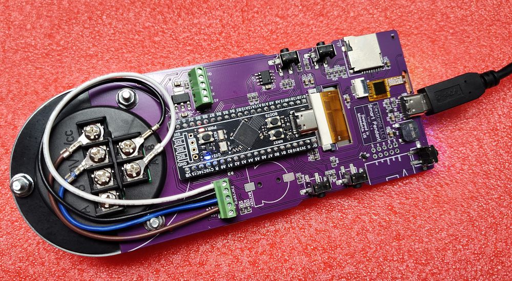

Hi Everyone,
I have some problems with DFU on Windows 10. I use WeAct BlackPill boards based on STM32F411 MCU. This board has BOOT0 button which allow to update firmware using STM32CubeProgrammer and DFU mode.
Majority of the boards can be programmed in DFU mode using STM32CubeProgrammer with no issue. Recently I got couple boards that acts very weird: those boards enters DFU mode just fine, detects by STM32CubeProgrammer and able to connect, but as soon I try to erase or program those boards - STM32CubeProgrammer says "Connection lost" and that is it. After that those boards enters into DFU mode, STM32CubeProgrammer able to read serial number, but any attempt to connect failed:

If I use ST-Link to program those boards, I able to connect in DFU mode again... until I try to reprogram it. Then same problem with connection appears again.
I tried two different cables and three different laptops - same result.
But then I decided to try another PC with Windows 11 and it works! It works every single time on two different Windows 11 based laptops with no problems! STM32CubeProgrammer version is the same(2.18), so it is not that, it is something else. I wondering what it can be.
I really want this issue to be fixed, because I can't use those boards for my SmartPendant project to control CNC machines based on grblHAL controllers, since it will be impossible to update firmware under Windows 10, and even worse - attempt bricks device until it will be reprogrammed on Windows 11.

I make those devices and sell them to hobbyists like me who converting benchtop mills/lathes into CNC. They can use different OS and I have no control of it. I couldn't just say "Oh, you have a problem? Time to update!". Beside, I tried it on Windows. Will it have same problem on MacOS? On a Linux? I don't know. But what I do know there some problems with some of MCU, because some boards work and some don't. And those problems potentially can be fixed on STM32CubeProgrammer side since it works flawlessly on Windows 11.
And questions I want to be answered:
1) If it bug in MCU, does it affect anything beside DFU? Crushing CNC machine is not fun.
2) Will it be fixed in STM32CubeProgrammer?

Just to be clear. Most of Black/Blue (other colors) Pill don't contain a genuine STM32 chip. I suggest you to purchase a ST board instead. NUCLEO-F411RE is a choice.

I am well aware of fake STM32F1 MCUs, but I did not found any information about fake STM32F411 MCUs. I purchased those board from WeAct Studio official store on AliExpress, link can be found on their GitHub page: https://github.com/WeActStudio/WeActStudio.MiniSTM32F4x1
They claimed that all ICs they using "are functional and original". They also have another boards with MCUs like STM32H743, STM32U585CIU6, STM32G474CEU6 and I don't think that fake versions of those MCUs exists.
As for using Nucleo... how I suppose to fit it inside device on photos I posted? Rhetorical question.
If you like, I am willing to mail board to ST(within the United States) for further investigation. I also can try to decapping one of MCU to check if it genuine, but don't know if 5W diode laser engraver will do the trick.

I am not so sure. Stm32CubeProgrammer the same, MCU is the same, then problem probably somewhere else, not in DFU bootloader itself. Different USB stack with different timeouts? Some timing issues? Crystal oscillator out of tolerances slightly? I don't know, it can be anything. I probably should to try use USB sniffer to check the difference...

When it works fine under Win11 but not Win10, this most probably excludes the board or the PC itself. I would have suspected power supply issues in this case.
But I have experienced quite a lot of issues with Windows in combination with certain USB / serial adapters, and it's associated drivers. Up to frequent bluescreens with certain devices, which work perfectly fine under Linux.
In this case, it might be also be the USB hub / host controller driver.
Usually a PC contains several such controllers, i.e. one for all the ports at the backside and one for the ports at the side or front. Thus just plugging it into another port might help, too.
And with a serial / USB adapter involved, you could experiment with the settings in "properties->advanced" in the device manager, like block size or timeout values.

Update: Connection doesn't work when I connect board directly to one of USB ports on laptop itself, but works if I connect it to dock station connected to the same laptop via USB-C. I also noticed that there different Verbosity Levels in STM32CubeProgrammer. I set it to 3, and when it doesn't work, this is what it shows:

 I probably should done it earlier. Search this error shows that I am not alone:
Error - libusb control transfer error [-9] : LIBUSB_ERROR_PIPE
STM32CubeProgrammer 2.14.0 firmware update error over USB in Windows 10 64 bit
STM32CubeProgrammer DFU instable
I highly doubt that everyone in those topics has fake MCUs. I assume ST will not resolve this issue.
@Andrew Neil wrote:
It seems that @Shlapunov.Nicolai has the PCB design resources - so why not just put the SMT32 straight onto the PCB? Why the plug-in board at all?
It is an hobby project, it started with all off the shelf modules. Then I decided to make a board to make it smaller. Initial idea was to use BlackPill connected to the board which will allow to replace it if it will be damaged, but turns out that while round connectors smaller than regular squire ones, it still make device too thick. My board contains only two layers, BlackPill has more. I am not sure if it can be done in two layers. More layers - more expensive board. Then placement fees, other parts cost and with volume of 10-30 boards it just doesn't give any benefits for this hustle.
And even if I'll do all this, when something will go wrong, some ST Employee probably will say "LCSC and JLCPCB is Chinese companies, may be they sourced fake STM32s" :D
mƎALLEm
mƎALLEmBest answer
April 14, 2025
ST resources are dedicated to supporting genuine ST products. We are not committed to ensuring that clones/fakes work properly with the firmware we provide.
Thank you for your understanding.
