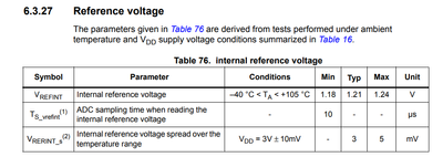

One more related question, I have changed the pins and now i am reading the voltage but all the pins are giving me a voltage of 1.7v while my actual value is 1.2-1.4v. I use Vref internal 3v.
Can anyone guide me what i am doing wrong?
I think it has to do with the value of my Vref

Sarra.S
Hello @sal92
According to your product datasheet, the internal reference voltage (VREFINT) for the STM32F733xx is typically 1.21 V, with a minimum of 1.18 V and a maximum of 1.24 V.
The internal reference voltage is not perfect. But it has been characterized in factory at a specific VREF+ voltage. You can use this to measure your actual VREF voltage. These values are stored in ROM.
ST has defined macros to access these ROM values in *ll_adc.h:
#define VREFINT_CAL_ADDR                   ((uint16_t*) (0x1FF1E860UL)) /* Internal voltage reference, address of parameter VREFINT_CAL: VrefInt ADC raw data acquired at temperature 30 DegC (tolerance: +-5 DegC), Vref+ = 3.3 V (tolerance: +-10 mV). */
#define VREFINT_CAL_VREF                   (3300UL)
Not all MCUs use the same calibration voltage so it is recommended to use both these macros (or use the HAL functions)
I recommend writing an init function that reads this ROM value once and uses it to create a multiplication value. You can combine this with the ADC full_scale value of 2^N-1 to create a multiplier.

This means the internal reference voltage in this case is about:
VREFINT_CAL_VREF * VREFINT_CAL_VALUE / FULL_SCALE = 3300 mV * 1531 / 4095 1234 mV
init:
multiplier = VREFINT_CAL_VALUE * VREFINT_CAL_VREF = 5052.3
measure:
vrefint channel counts (you need to measure this every time in case your VREF+ drifts or changes) = 1605
channel 1 counts = 2000
calc:
vref+ = multiplier / vrefint channel counts = 3.14785 V
channel 1 voltage = channel 1 counts * vref+ * (1.0f/FULL_SCALE) = 2.026V
