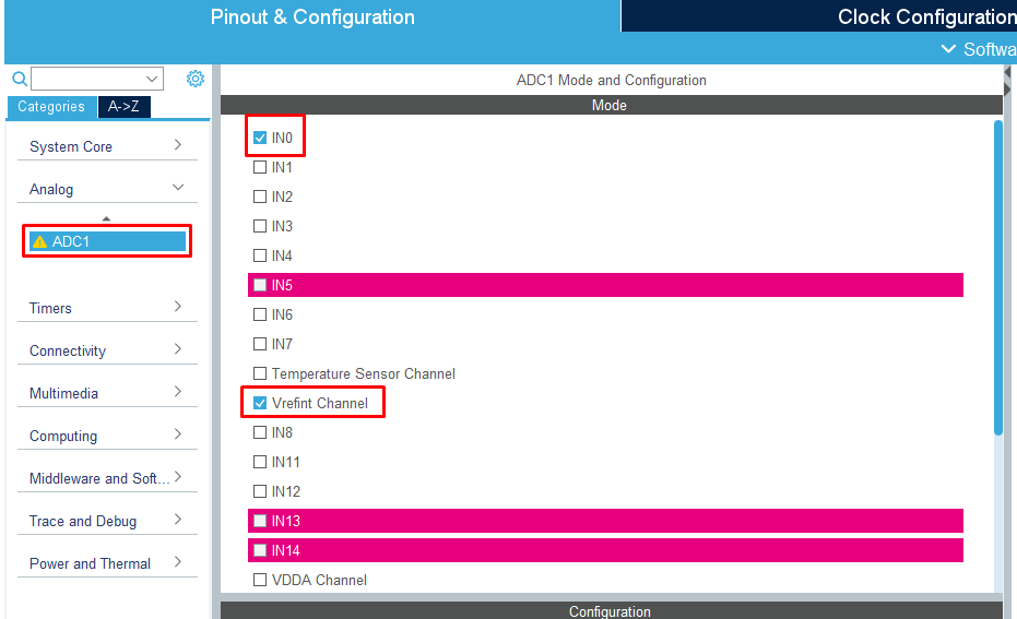

1. CubeMX Setup

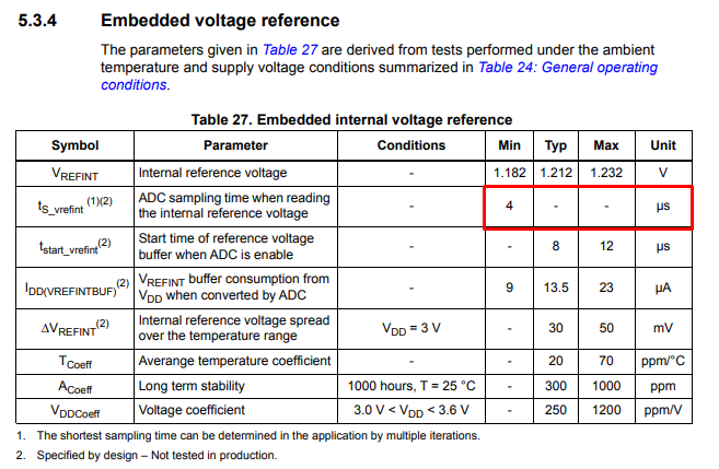

In CubeMX, we set up two channels: A channel of a voltage we want to read, and another channel, which is the VREF internal channel. We need to understand how long to sample the VREF internal channel. The datasheet for C031 shows that the internal reference voltage needs to be sampled for at least 4us. From DS13867, Table 27:

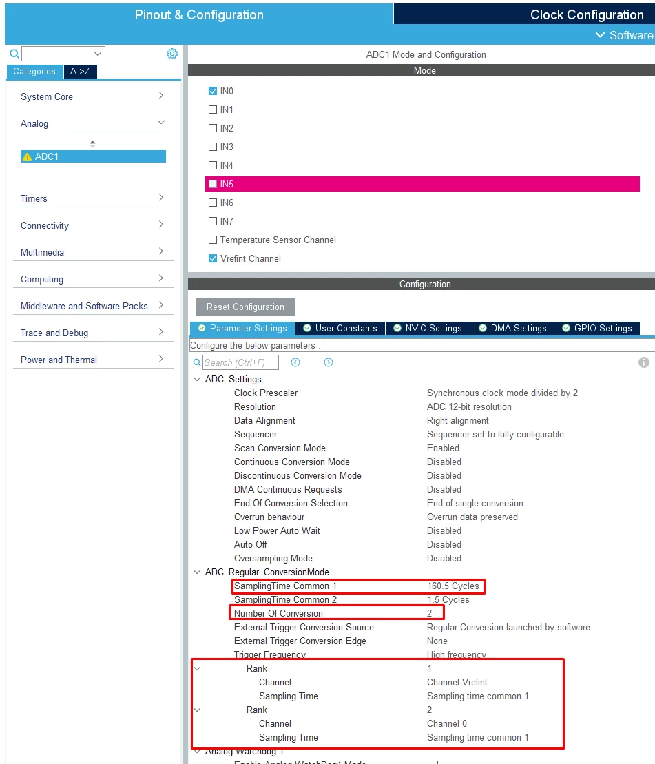

In CubeMX, we enable the ADC channels we want to use:

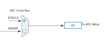

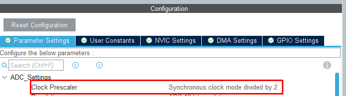

In the clock tree, the ADC is getting its clock from the system clock running at 48MHz, which is prescaled by 2 in the ADC configuration.
Knowing our ADC clock is 24MHz, we can calculate the minimum sampling time:
4u / (1 / 24M) = 96
Out of the available sampling time options, 160.5 cycles is the only option that is greater than or equal to 96. Therefore, we use that sampling time.
I am using the same sampling time for Channel 0, but you can feel free to use whatever sampling time you prefer for that channel. That is all for the CubeMX configuration and now we can generate code.

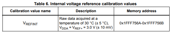

During factory programming, a calibration value of the raw ADC data of VREF internal at a known temperature and VDDA was collected and stored in ROM. From DS13867, Table 6:

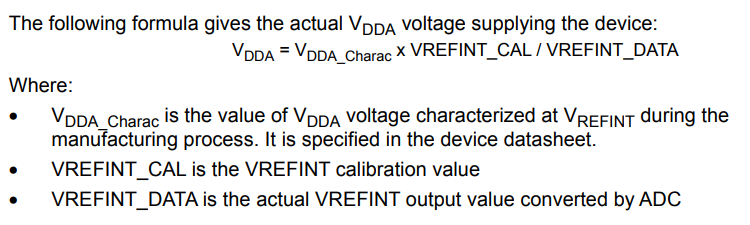

Using this calibration value presented below, along with the measured VREF internal in the application, the VDDA can be calculated. The formula below was obtained from the C0x1 reference manual, RM0490 page 274:

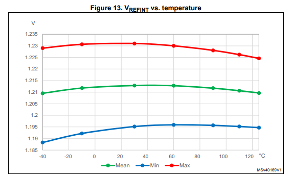

Since the HAL library provides a macro to do this calculation, there is not a need to implement this, but it is good to understand how it works. It is also worth mentioning that VREF internal does have some variance over temperature, which is roughly characterized in the datasheet, DS13867 Figure 13:
Since the characterizations are not precise and there is per device variance, for best performance in extreme temperature ranges it would be necessary to characterize this temperature coefficient experimentally.
