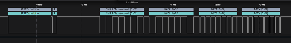

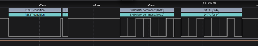

BUT, instead of Temperature readings, I have 0xFF value all the time.
Then I've checked the Sensor's data pin on logic analyzer.
I could read the 1-Wire Communication routine on the sensor, and actual temperature data as well (picture below).
So, that's means, that the sensor operating well and I cannot receive any data from the sensor's convert Function.
Now, I'm stuck. What could be wrong with my ds18b20 Library, with its main conversion function?
I tried to check the Sensor's reset function and found it was working ok.
Maybe, I missed something in FreeRTOS Tasks procedures?
I would greatly appreciate any help!

FreerRTOS will mess with the timing of software-timed 1-wire transfers.  Depending on interrupts and other task priorities your Delay_us() calls could be much much longer if a task switch or interrupt happens during your Delay_us(5) when the GPIO pin is low.  That would cause the temperature chip to reset/reboot in the middle of the transaction.
For example, the "reset" pulse looks to be almost 1ms wide, not the 480us that you expect.  I don't know that the 1-wire protocol specifies as max "low" time, but that looks suspicious.
In the 2nd image you posted, I see the labels above the last 2 bytes saying 0x88 and 0x01 but the data lines do not look like that data (to my eyeballs).

MM..1
Chief III
Your library is writed for use without multithread or long ISR code. You can try rewrite it based on timer or record with DMA and then decode. But more simpler is thermal sensors with ADC I2C or an supported bus on MCU
Thank you for your reply!
The data has 2 last bytes, 0x88 and 0x01. LSB is going first. So, the temperature data is 0x0188, which is 392 in dec. To get the temperature, I need 392/16=24.5C. Which is actual temperature in my room.
With time delays, you are right. After analyzing, I noticed one issue. All delays of Delay_us() function, are twice longer as supposed to be, exactly twice. The HAL_Delay() doesn't has such issue and long as supposed to be.
So, all delays of Delay_us() function I divided by 2. After that, I succeeded to read the temperature on the Display. The timings on analyzer became correct.
Looks like, the sensor was converting the temperature, but the function couldn't read it because of the incorrect timings.
I need to reconsider my Delay_us() function.
