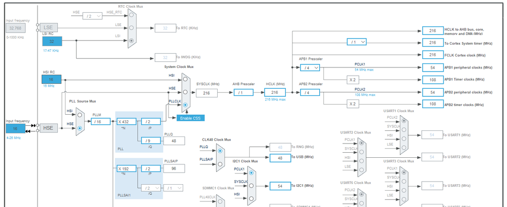

Hello, for the last couple of days I've been trying to set up my STM32F723ZET6 project as a USB HS CDC device with internal PHY.
My code gets stuck in this loop
  do
    count++;
    if (count > HAL_USB_TIMEOUT)
      return HAL_TIMEOUT;
  } while ((USBx->GRSTCTL & USB_OTG_GRSTCTL_CSRST) == USB_OTG_GRSTCTL_CSRST);
inside the function .staticHAL_StatusTypeDefUSB_CoreReset(USB_OTG_GlobalTypeDef *USBx) in the file stm32f7xx_ll_usb.c
I've been reading and it seems like a common issue. I've tried applying some solution that work for other people, although they were asking for other models of STM, Without success.
For what I read it seems to be some kind of timing or clock problem. I have no experience with USB and I don't really know much about how CUBEMX implementation works.

Clock configuration:
Every other Mux not shown in the picture is greyed out

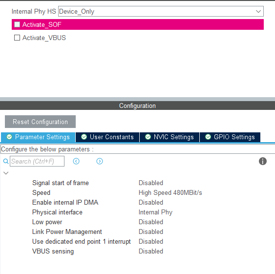

USB_OTG_HS config

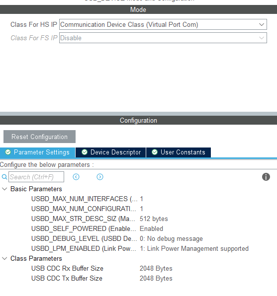

USB_Device Config

One of the things chatGPT suggested was about the VBUS detection. It says that it must be enabled (it may be talking about other STM32 model). I didn't find any PWR configuration in my pinout view, not under System Core neither in the categories list. I don't know if my version of STM manages that internally.

Read out and check content of all registers related to the PHY's supply and clock. Measure voltage on VDD12OTGHS pin. Make sure RCC_APB2ENR.OTGPHYCEN is enabled as well as RCC_AHB1ENR.OTGHSEN , and that USBPHYC_PLL1 is set properly. Also make sure HSE is working as intended, perhaps outputting it to MCO.

Thanks for your reply, I checked the registers and RCC_APB2ENR.OTGPHYCEN and RCC_AHB1ENR.OTGHSEN are both enabled.
I checked the value of USBPHYC_PLL1, it is enabled and set to 16Mhz (I don't really know what those 16Mhz mean)
I also checked USBPHYC_LDO and USBPHYC_LDO.LDO_DISABLE is set to 1, I don't know if the LDO should be enabled at the point of the core reset.
I measured the voltage at the VDD12OTGHS pin and it's 1.25V
I did a Master Clock output and got a frequency reading of 16Mhz
