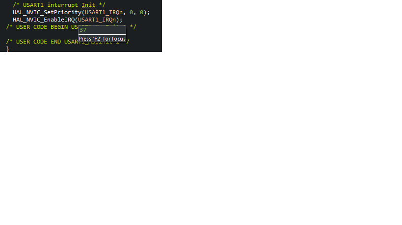

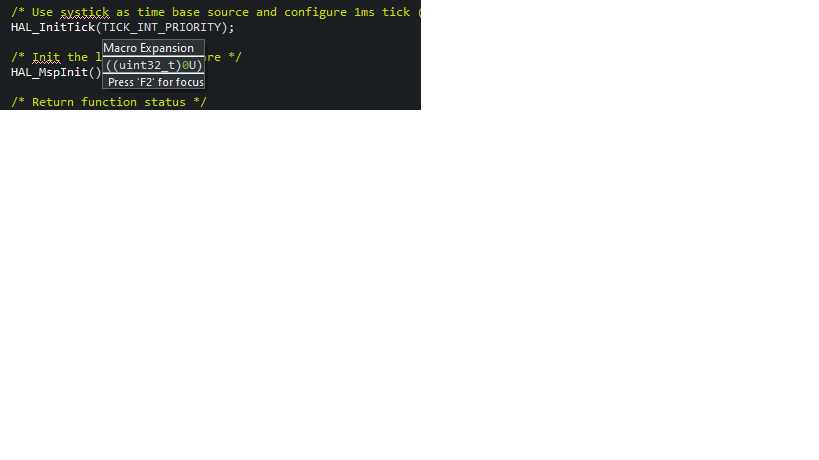

Hi @TDK​ , I've checked that I made a mistake about the systick interrupt number is not "-1" but 0, about the interrupt number I've checked this in the initialization code made by STMCube IDE (please see the images):
The image bellow is the systick interrupt number
0693W0000059ESqQAM.pngthe image bellow is the USART1 interrupt number
0693W0000059ESvQAM.pngthe code expander of the STM32Cube IDE shows that those interrupts are 0 and 37 for systick and usart1 interrupts, in addition, the code in the main loop has several HAL_Delay() calls and those are working correctly which means that systick interrupt is working but is not preempting the usart1 IRQ handler, so I don't know what I'm missing here.
Looks like both interrupts have a priority of 0, so they can't pre-empt each other.
USART1_IRQn (37) is the number of the interrupt, not the priority level. The second argument is the priority level.
HAL_Delay works in the main loop since it's not within an interrupt.
Thanks again @TDK​ , I was confused about the arguments of the Set_Priority function and yes, now I see that both interrupt has the same priority so none of them can interrupt the other, I've changed the interrupt preempt priority of the usart1 to 1 and now is working as expected.
