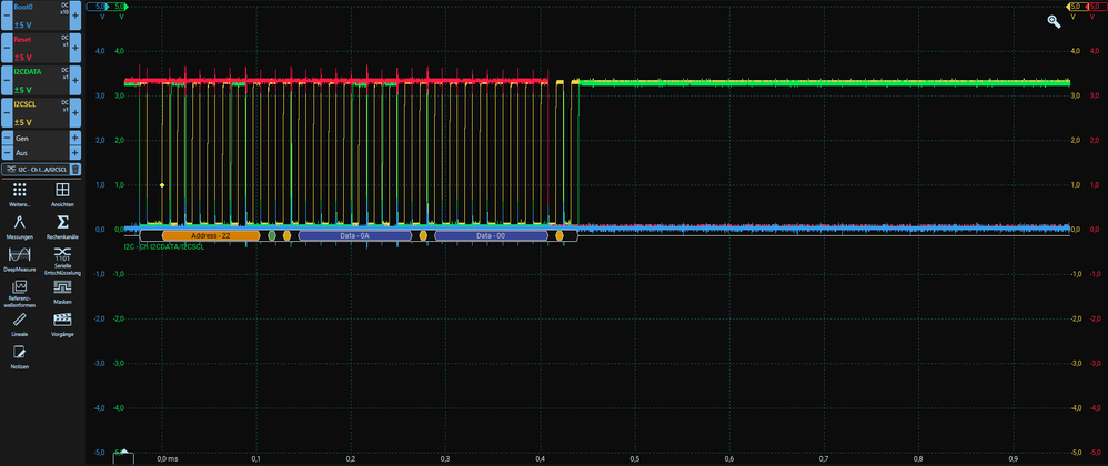

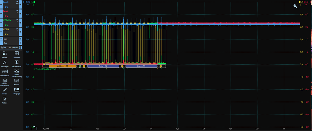

even non-stretch commands (non-stretch memory erase command) drop the SCL to zero without recovering. SCL stays low, when master is disconnected. Here are 2 pictures of the signals captured with an oscilloscope. First picture shows an successful erase (workaround), second picture shows the SCL failure of non-stretch memory erase command.
blue -> boot0 pin, red -> reset pin , yellow -> I2C SCL, green -> I2C SDA
erase success (workaround)erase success (workaround)erase failerase fail

It is definitely an error case caused by the microcontroller. As soon as SCL is broken by reading/writing at address 0x5d and the master is removed, it does not recover. The Clock only recovers after a power cycle. Even if a read command (i2cget) is sent to bootloader address 0x5d (after reset + boot0 pin to high), the clock collapses as shown in the oscilloscope image.
How hw sw you use as master? First clk pulse isnt ideal
Okay, so SCL is being stretched on the next command. Can you show the full transaction, starting with NRST rising edge?
Not saying there isn't an issue, but the plot you've shown only shows that clock stretching is happening which isn't an issue in itself.
A non-stretch memory command requires polling for an ACK byte before the next command is sent, which isn't shown.

The clock stretching begins even with no-stretch commands. The erase fail.png attached is captured after sending the first two bytes. I use i2ctransfer command to send these two bytes to address 0x5d as follows:
i2ctransfer 1  w2@0x5d 0x45 0xBA
As I said, the clock is not recovering unless a Power Cycle is done. If clock stretching is enabled, shouldn't it recover at some point?
